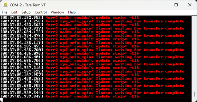

I tried to run the example code for the ws2812 (which can be found at C:\ncs\v2.4.1\v2.4.1\zephyr\samples\drivers\led_ws2812) for the nRF52832 using nRF Connect SDK (v2.4.1).
Looking at the nrf52dk_nrf52832.overlay, it looks like MOSI would be used on P0.23.
&arduino_spi { /* MOSI on D11 / P0.23 */
I am trying to experiment using the nRF52 DK board.
I have a known working LED ring which lights up from another board.
The code builds fine but when I run it, I see the following in the terminal.
Using a Saleae Logic analyzer, I don't see anything on P0.23.
I tried adding the following from nrf52dk_nrf52832.dts but I ended up with the same message in the terminal and didn't see anything on the logic analyzer.
I tried multiple pins and couldn't see any changes on the IO lines that looked like the required signal for the WS2812 LEDs.

  • I tried to see if I could move the MOSI from P0.23 to a P0.08 and it seems to have broken something.
    I tried the following to change the pin and it didn't seem to work.
    &spi2_default {
        group1 {
            psels = <NRF_PSEL(SPIM_MOSI, 0, 8)>;
    &spi2_sleep {
        group1 {
    I tried to remove this code and now I can't get the LED ring to work at all using P0.23.
    I hooked up the UART and it is spitting out the following message.
    As far as I can tell the code is back to the original of what I started with.  I am using NCS 2.5.0-rc2

  • Can you create a new project and copy the /led_ws2812 sample?  should not need to re-install NCS every time.
    	spi2_default: spi2_default {
    		group1 {
    			psels = <NRF_PSEL(SPIM_SCK, 0, 25)>,
    				<NRF_PSEL(SPIM_MOSI, 0, 23)>,
    				<NRF_PSEL(SPIM_MISO, 0, 24)>;
    	spi2_sleep: spi2_sleep {
    		group1 {
    			low-power-enable;
    This should be what it originally was, does it not work when you revert to using the setup ?
