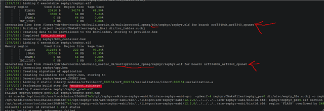

section `rodata' will not fit in region `FLASH'
Summary: I get an error that section `rodata' will not fit in region `FLASH' when building a Matter custom template device and I am unsure what configuration changes I should make. I am using NRF Connect SDK 2.5.0. I am first trying to build for the NRF5340-DK, but I also have my own custom board (with same external flash, mx25r64, as the Nordic DK board). I am not sure what is the best way to increase the FLASH region so that I can build my program. Welcome your advice and guidance. Thanks! Dan.
Here is the error I get when building for the nrf5340-DK:
/opt/nordic/ncs/toolchains/20d68df7e5/opt/zephyr-sdk/arm-zephyr-eabi/bin/../lib/gcc/arm-zephyr-eabi/12.2.0/../../../../arm-zephyr-eabi/bin/ld.bfd: zephyr/zephyr_pre0.elf section `rodata' will not fit in region `FLASH'
/opt/nordic/ncs/toolchains/20d68df7e5/opt/zephyr-sdk/arm-zephyr-eabi/bin/../lib/gcc/arm-zephyr-eabi/12.2.0/../../../../arm-zephyr-eabi/bin/ld.bfd: region `FLASH' overflowed by 248 bytes
collect2: error: ld returned 1 exit status
I've looked at the related tickets, but am not sure if the root cause is the same:
 https://devzone.nordicsemi.com/f/nordic-q-a/105338/section-rodata-will-not-fit-in-region-flash
 https://devzone.nordicsemi.com/f/nordic-q-a/106910/section-rodata-will-not-fit-in-region-flash-bin-ld-exe-region-flash-overflowed-by-6134-bytes

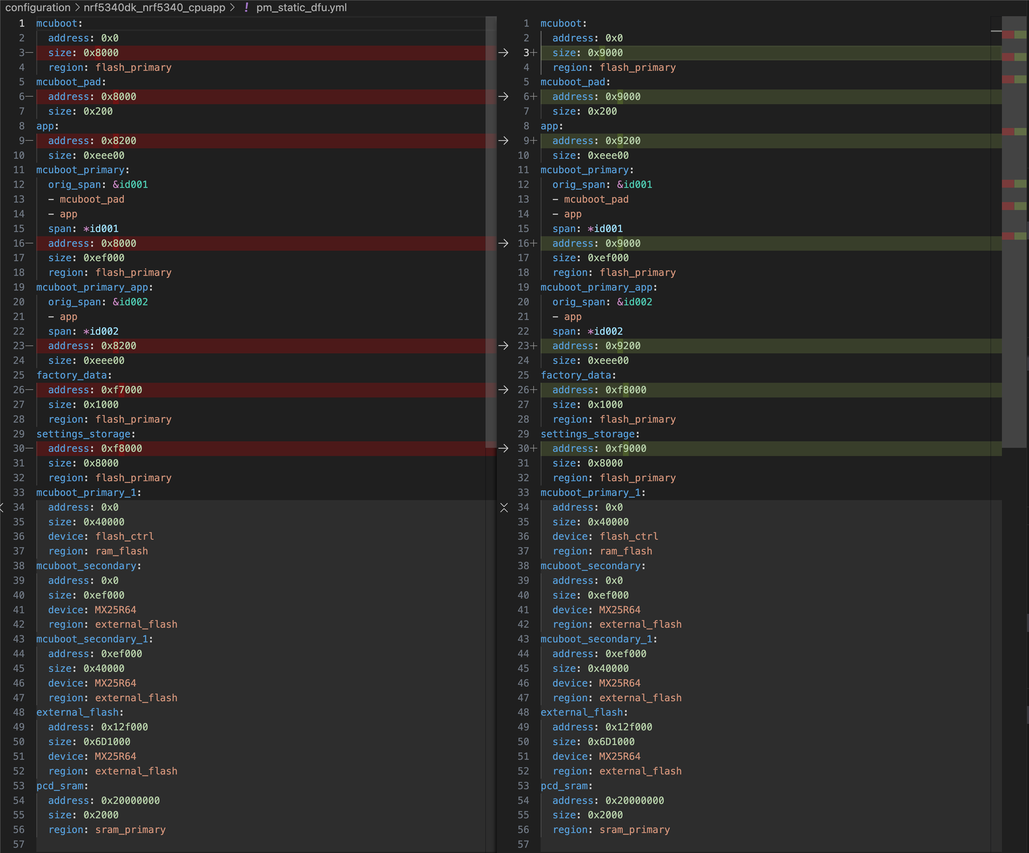

Here is my pm_static_dfu.yml
mcuboot:
  address: 0x0
  region: flash_primary
mcuboot_pad:
  address: 0x8000
app:
  address: 0x8200
mcuboot_primary:
  orig_span: &id001
  - mcuboot_pad
  - app
  span: *id001
  address: 0x8000
mcuboot_primary_app:
  orig_span: &id002
  - app
  span: *id002
  address: 0x8200
factory_data:
  address: 0xf7000
settings_storage:
  address: 0xf8000
mcuboot_primary_1:
  address: 0x0
  device: flash_ctrl
  region: ram_flash
mcuboot_secondary:
  address: 0x0
  device: MX25R64
  region: external_flash
mcuboot_secondary_1:
  address: 0xef000
  device: MX25R64
external_flash:
  address: 0x12f000
  device: MX25R64
pcd_sram:
  address: 0x20000000
  region: sram_primary

As an aside, during the build, the memory regions seem to be within the capacity available:
[139/139] Linking C executable zephyr/zephyr.elf
           FLASH:       23410 B      34176 B     68.50%
             RAM:        3500 B        64 KB      5.34%
           SRAM1:          0 GB        64 KB      0.00%
        IDT_LIST:          0 GB         2 KB      0.00%
[272/282] Building C object zephyr/CMakeFiles/zephyr_final.dir/isr_tables.c.obj
[273/282] Creating data to be provisioned to the Bootloader, storing to provision.hex
[275/282] Completed 'b0n_subimage'
[277/282] Generating zephyr/b0n_container.hex
[278/282] Linking C executable zephyr/zephyr.elf
           FLASH:      212184 B       222 KB     93.34%
             RAM:       53704 B        64 KB     81.95%
[279/282] Generating zephyr/app.hex
    The error does indeed mean that one of the images are out of memory.
    The build system will print a memory report for each image built successfully, but not for the ones which fail. So the one which ran out of space is not printed.
    Could you paste the full build log into a Code box, so I can see which image gets the error?
    If you want want to add some more information to which image each memory report is for, see PR-66217 on the zephyr project. It is only 3 lines so you could patch it in your SDK if you want.
    Sigurd Hellesvik

    [56/139] Building ASM object zephyr/arch/arch/arm/core/aarch32/cortex_m/CMakeFiles/arch__arm__core__aarch32__cortex_m.dir/fault_s.S.obj
    [57/139] Building ASM object zephyr/arch/arch/arm/core/aarch32/cortex_m/CMakeFiles/arch__arm__core__aarch32__cortex_m.dir/reset.S.obj
    [58/139] Building C object zephyr/arch/arch/arm/core/aarch32/cortex_m/CMakeFiles/arch__arm__core__aarch32__cortex_m.dir/fpu.c.obj
    [59/139] Building C object zephyr/arch/arch/arm/core/aarch32/cortex_m/CMakeFiles/arch__arm__core__aarch32__cortex_m.dir/irq_init.c.obj
    [60/139] Building C object zephyr/arch/arch/arm/core/aarch32/CMakeFiles/arch__arm__core__aarch32.dir/__/common/tls.c.obj
    [61/139] Building C object zephyr/arch/arch/arm/core/aarch32/cortex_m/CMakeFiles/arch__arm__core__aarch32__cortex_m.dir/scb.c.obj
    [62/139] Building ASM object zephyr/arch/arch/arm/core/aarch32/cortex_m/CMakeFiles/arch__arm__core__aarch32__cortex_m.dir/vector_table.S.obj
    [63/139] Building ASM object zephyr/arch/arch/arm/core/aarch32/cortex_m/CMakeFiles/arch__arm__core__aarch32__cortex_m.dir/__aeabi_read_tp.S.obj
    [64/139] Building C object zephyr/lib/libc/common/CMakeFiles/lib__libc__common.dir/source/stdlib/malloc.c.obj
    [65/139] Building C object zephyr/arch/arch/arm/core/aarch32/cortex_m/CMakeFiles/arch__arm__core__aarch32__cortex_m.dir/thread_abort.c.obj
    [66/139] Building C object zephyr/lib/libc/common/CMakeFiles/lib__libc__common.dir/source/stdlib/abort.c.obj
    [67/139] Building C object zephyr/arch/arch/arm/core/aarch32/cortex_m/cmse/CMakeFiles/arch__arm__core__aarch32__cortex_m__cmse.dir/arm_core_cmse.c.obj
    [68/139] Building C object zephyr/lib/libc/picolibc/CMakeFiles/lib__libc__picolibc.dir/libc-hooks.c.obj
    [69/139] Building C object zephyr/drivers/console/CMakeFiles/drivers__console.dir/uart_console.c.obj
    [70/139] Building C object zephyr/drivers/flash/CMakeFiles/drivers__flash.dir/soc_flash_nrf.c.obj
    [71/139] Building C object zephyr/drivers/clock_control/CMakeFiles/drivers__clock_control.dir/clock_control_nrf.c.obj
    [72/139] Linking C static library zephyr/arch/common/libisr_tables.a
    [73/139] Building C object zephyr/drivers/flash/CMakeFiles/drivers__flash.dir/flash_page_layout.c.obj
    [74/139] Building C object zephyr/drivers/pinctrl/CMakeFiles/drivers__pinctrl.dir/pinctrl_nrf.c.obj
    [75/139] Building C object zephyr/drivers/pinctrl/CMakeFiles/drivers__pinctrl.dir/common.c.obj
    [76/139] Linking C static library zephyr/libzephyr.a
    [77/139] Building C object zephyr/drivers/serial/CMakeFiles/drivers__serial.dir/uart_nrfx_uarte.c.obj
    [78/139] Building C object zephyr/drivers/timer/CMakeFiles/drivers__timer.dir/nrf_rtc_timer.c.obj
    [79/139] Linking C static library zephyr/arch/arch/arm/core/aarch32/libarch__arm__core__aarch32.a
    [80/139] Linking C static library zephyr/arch/arch/arm/core/aarch32/cortex_m/libarch__arm__core__aarch32__cortex_m.a
    [81/139] Linking C static library zephyr/arch/arch/arm/core/aarch32/cortex_m/cmse/libarch__arm__core__aarch32__cortex_m__cmse.a
    [82/139] Linking C static library zephyr/lib/libc/common/liblib__libc__common.a
    [83/139] Linking C static library zephyr/drivers/console/libdrivers__console.a
    [84/139] Linking C static library zephyr/lib/libc/picolibc/liblib__libc__picolibc.a
    [85/139] Linking C static library zephyr/drivers/clock_control/libdrivers__clock_control.a
    [86/139] Building C object modules/nrf/subsys/bootloader/bl_boot/CMakeFiles/..__nrf__subsys__bootloader__bl_boot.dir/bl_boot.c.obj
    [87/139] Building C object zephyr/drivers/timer/CMakeFiles/drivers__timer.dir/sys_clock_init.c.obj
    [88/139] Linking C static library zephyr/drivers/pinctrl/libdrivers__pinctrl.a
    [89/139] Building C object modules/nrf/subsys/bootloader/bl_crypto/CMakeFiles/..__nrf__subsys__bootloader__bl_crypto.dir/bl_crypto_oberon_hash.c.obj
    [90/139] Building C object modules/nrf/subsys/bootloader/bl_crypto/CMakeFiles/..__nrf__subsys__bootloader__bl_crypto.dir/bl_crypto.c.obj
    [91/139] Building C object modules/nrf/lib/fatal_error/CMakeFiles/..__nrf__lib__fatal_error.dir/fatal_error.c.obj
    [92/139] Building C object modules/nrf/lib/fprotect/CMakeFiles/..__nrf__lib__fprotect.dir/fprotect_acl.c.obj
    [93/139] Linking C static library zephyr/drivers/flash/libdrivers__flash.a
    [94/139] Building C object modules/nrf/subsys/bootloader/bl_validation/CMakeFiles/..__nrf__subsys__bootloader__bl_validation.dir/bl_validation.c.obj
    [95/139] Building C object modules/nrf/subsys/bootloader/bl_storage/CMakeFiles/..__nrf__subsys__bootloader__bl_storage.dir/bl_storage.c.obj
    [96/139] Building C object modules/nrf/subsys/pcd/CMakeFiles/..__nrf__subsys__pcd.dir/src/pcd.c.obj
    [97/139] Linking C static library zephyr/arch/common/libarch__common.a
    [98/139] Building C object modules/nrf/subsys/fw_info/CMakeFiles/..__nrf__subsys__fw_info.dir/fw_info.c.obj
    [99/139] Building C object modules/hal_nordic/nrfx/CMakeFiles/modules__hal_nordic__nrfx.dir/opt/nordic/ncs/v2.5.0/modules/hal/nordic/nrfx/mdk/system_nrf5340_network.c.obj
    [100/139] Linking C static library zephyr/drivers/serial/libdrivers__serial.a
    [101/139] Building C object modules/hal_nordic/nrfx/CMakeFiles/modules__hal_nordic__nrfx.dir/opt/nordic/ncs/v2.5.0/modules/hal/nordic/nrfx/helpers/nrfx_flag32_allocator.c.obj
    [102/139] Building C object modules/hal_nordic/nrfx/CMakeFiles/modules__hal_nordic__nrfx.dir/nrfx_glue.c.obj
    [103/139] Linking C static library modules/nrf/subsys/bootloader/bl_boot/lib..__nrf__subsys__bootloader__bl_boot.a
    [104/139] Linking C static library modules/nrf/subsys/bootloader/bl_crypto/lib..__nrf__subsys__bootloader__bl_crypto.a
    [105/139] Linking C static library modules/nrf/lib/fatal_error/lib..__nrf__lib__fatal_error.a
    [106/139] Building C object modules/hal_nordic/nrfx/CMakeFiles/modules__hal_nordic__nrfx.dir/opt/nordic/ncs/v2.5.0/modules/hal/nordic/nrfx/helpers/nrfx_gppi_dppi.c.obj
    [107/139] Linking C static library zephyr/drivers/timer/libdrivers__timer.a
    [108/139] Linking C static library modules/nrf/lib/fprotect/lib..__nrf__lib__fprotect.a
    [109/139] Building C object modules/hal_nordic/nrfx/CMakeFiles/modules__hal_nordic__nrfx.dir/opt/nordic/ncs/v2.5.0/modules/hal/nordic/nrfx/drivers/src/nrfx_clock.c.obj
    [110/139] Linking C static library modules/nrf/subsys/bootloader/bl_storage/lib..__nrf__subsys__bootloader__bl_storage.a
    [111/139] Linking C static library modules/nrf/subsys/pcd/lib..__nrf__subsys__pcd.a
    [112/139] Building C object modules/hal_nordic/nrfx/CMakeFiles/modules__hal_nordic__nrfx.dir/opt/nordic/ncs/v2.5.0/modules/hal/nordic/nrfx/drivers/src/nrfx_nvmc.c.obj
    [113/139] Building C object modules/hal_nordic/nrfx/CMakeFiles/modules__hal_nordic__nrfx.dir/opt/nordic/ncs/v2.5.0/modules/hal/nordic/nrfx/drivers/src/nrfx_dppi.c.obj
    [114/139] Linking C static library modules/nrf/subsys/bootloader/bl_validation/lib..__nrf__subsys__bootloader__bl_validation.a
    [115/139] Building C object zephyr/kernel/CMakeFiles/kernel.dir/main_weak.c.obj
    [116/139] Building C object zephyr/kernel/CMakeFiles/kernel.dir/banner.c.obj
    [117/139] Building C object zephyr/kernel/CMakeFiles/kernel.dir/errno.c.obj
    [118/139] Building C object zephyr/kernel/CMakeFiles/kernel.dir/busy_wait.c.obj
    [119/139] Building C object zephyr/kernel/CMakeFiles/kernel.dir/device.c.obj
    [120/139] Building C object zephyr/kernel/CMakeFiles/kernel.dir/fatal.c.obj
    [121/139] Building C object zephyr/kernel/CMakeFiles/kernel.dir/init.c.obj
    [122/139] Linking C static library modules/nrf/subsys/fw_info/lib..__nrf__subsys__fw_info.a
    [123/139] Building C object zephyr/kernel/CMakeFiles/kernel.dir/version.c.obj
    [124/139] Building C object zephyr/kernel/CMakeFiles/kernel.dir/mem_slab.c.obj
    [125/139] Building C object zephyr/kernel/CMakeFiles/kernel.dir/kheap.c.obj
    [126/139] Building C object zephyr/kernel/CMakeFiles/kernel.dir/xip.c.obj
    [127/139] Building C object zephyr/kernel/CMakeFiles/kernel.dir/timeout.c.obj
    [128/139] Building C object zephyr/kernel/CMakeFiles/kernel.dir/thread.c.obj
    [129/139] Building C object zephyr/kernel/CMakeFiles/kernel.dir/dynamic_disabled.c.obj
    [130/139] Building C object zephyr/kernel/CMakeFiles/kernel.dir/mempool.c.obj
    [131/139] Building C object zephyr/kernel/CMakeFiles/kernel.dir/timer.c.obj
    [132/139] Linking C static library modules/hal_nordic/nrfx/libmodules__hal_nordic__nrfx.a
    [133/139] Linking C static library zephyr/kernel/libkernel.a
    [134/139] Linking C executable zephyr/zephyr_pre0.elf
    [135/139] Generating linker.cmd
    [136/139] Generating isr_tables.c, isrList.bin
    [137/139] Building C object zephyr/CMakeFiles/zephyr_final.dir/isr_tables.c.obj
    [138/139] Building C object zephyr/CMakeFiles/zephyr_final.dir/misc/empty_file.c.obj
    [279/282] Creating signature of application
    [280/282] Creating validation for zephyr.hex, storing to
    [282/282] Generating zephyr/merged_CPUNET.hex

  • That looks like MCUboot to me.
    So either reduce MCUboot size through configuration, or increase the MCUboot slot.
    To verify that it is MCUboot that is too large, I suggest you try to increase it from 0x8000 to 0x9000 to try, as this is the easiest way to check that.
    Also, which build command do you use?
  • I also just added the line of code you suggested from PR-66217 to my zephyr/CMakeLists.txt file and rebuilt. I did a pristine build which failed, followed by a build which produced the following log
    Generating files from /Users/ydr/dev/nordic/wb/build_nordic_dk/multiprotocol_rpmsg/b0n/zephyr/zephyr.elf for board: nrf5340dk_nrf5340_cpunet
    Generating files from /Users/ydr/dev/nordic/wb/build_nordic_dk/multiprotocol_rpmsg/zephyr/zephyr.elf for board: nrf5340dk_nrf5340_cpunet
    [186/272] Linking C static library modules/nrfxlib/nrf_802154/nrf_802154/serialization/libnrf-802154-serialization.a
    [187/272] Performing build step for 'mcuboot_subimage'
    [1/6] Linking C executable zephyr/zephyr_pre0.elf
    FAILED: zephyr/zephyr_pre0.elf zephyr/zephyr_pre0.map
    : && ccache /opt/nordic/ncs/toolchains/20d68df7e5/opt/zephyr-sdk/arm-zephyr-eabi/bin/arm-zephyr-eabi-gcc  -gdwarf-4 zephyr/CMakeFiles/zephyr_pre0.dir/misc/empty_file.c.obj -o zephyr/zephyr_pre0.elf  -fuse-ld=bfd  -T  zephyr/linker_zephyr_pre0.cmd  -Wl,-Map=/Users/ydr/dev/nordic/wb/build_nordic_dk/mcuboot/zephyr/zephyr_pre0.map  -Wl,--whole-archive  app/libapp.a  zephyr/libzephyr.a  zephyr/arch/common/libarch__common.a  zephyr/arch/arch/arm/core/aarch32/libarch__arm__core__aarch32.a  zephyr/arch/arch/arm/core/aarch32/cortex_m/libarch__arm__core__aarch32__cortex_m.a  zephyr/arch/arch/arm/core/aarch32/cortex_m/cmse/libarch__arm__core__aarch32__cortex_m__cmse.a  zephyr/arch/arch/arm/core/aarch32/mpu/libarch__arm__core__aarch32__mpu.a  zephyr/lib/libc/picolibc/liblib__libc__picolibc.a  zephyr/lib/libc/common/liblib__libc__common.a  zephyr/soc/soc/arm/common/cortex_m/libsoc__arm__common__cortex_m.a  zephyr/drivers/clock_control/libdrivers__clock_control.a  zephyr/drivers/flash/libdrivers__flash.a  zephyr/drivers/pinctrl/libdrivers__pinctrl.a  zephyr/drivers/timer/libdrivers__timer.a  modules/nrf/lib/fprotect/lib..__nrf__lib__fprotect.a  modules/nrf/subsys/pcd/lib..__nrf__subsys__pcd.a  modules/nrf/modules/mcuboot/hooks/lib..__nrf__modules__mcuboot__hooks.a  modules/nrf/drivers/hw_cc310/lib..__nrf__drivers__hw_cc310.a  modules/mcuboot/boot/bootutil/zephyr/libmcuboot_util.a  modules/mbedtls/libmbedTLSBase.a  modules/mbedtls/libmbedTLSCrypto.a  modules/mbedtls/libmbedTLSX509.a  modules/mbedtls/libmodules__mbedtls.a  modules/hal_nordic/nrfx/libmodules__hal_nordic__nrfx.a  modules/zcbor/libmodules__zcbor.a  -Wl,--no-whole-archive  zephyr/kernel/libkernel.a  zephyr/CMakeFiles/offsets.dir/./arch/arm/core/offsets/offsets.c.obj  -L"/opt/nordic/ncs/toolchains/20d68df7e5/opt/zephyr-sdk/arm-zephyr-eabi/bin/../lib/gcc/arm-zephyr-eabi/12.2.0/thumb/v8-m.main/nofp"  -L/Users/ydr/dev/nordic/wb/build_nordic_dk/mcuboot/zephyr  -lgcc  zephyr/arch/common/libisr_tables.a  modules/mbedtls/libmbedTLSBase.a  modules/mbedtls/libmbedTLSCrypto.a  modules/mbedtls/libmbedTLSX509.a  -mcpu=cortex-m33  -mthumb  -mabi=aapcs  -mfp16-format=ieee  -Wl,--gc-sections  -Wl,--build-id=none  -Wl,--sort-common=descending  -Wl,--sort-section=alignment  -Wl,-u,_OffsetAbsSyms  -Wl,-u,_ConfigAbsSyms  -nostdlib  -static  -Wl,-X  -Wl,-N  -Wl,--orphan-handling=warn  -Wl,-no-pie  -DPICOLIBC_INTEGER_PRINTF_SCANF  /opt/nordic/ncs/v2.5.0/nrfxlib/crypto/nrf_cc312_platform/lib/cortex-m33/soft-float/no-interrupts/libnrf_cc312_platform_0.9.18.a  --specs=picolibc.specs  -lc  -lgcc && cd /Users/ydr/dev/nordic/wb/build_nordic_dk/mcuboot/zephyr && /opt/nordic/ncs/toolchains/20d68df7e5/Cellar/cmake/3.20.5/bin/cmake -E true
    [189/272] Completed 'multiprotocol_rpmsg_subimage'
    FAILED: modules/mcuboot/mcuboot_subimage-prefix/src/mcuboot_subimage-stamp/mcuboot_subimage-build mcuboot/zephyr/zephyr.hex mcuboot/zephyr/zephyr.elf
    cd /Users/ydr/dev/nordic/wb/build_nordic_dk/mcuboot && /opt/nordic/ncs/toolchains/20d68df7e5/Cellar/cmake/3.20.5/bin/cmake --build . --
    [191/272] Generating ../../zephyr/net_core_app_update.bin
    image.py: sign the payload
    [192/272] Generating ../../zephyr/net_core_app_signed.hex
    FATAL ERROR: command exited with status 1: /opt/nordic/ncs/toolchains/20d68df7e5/bin/cmake --build /Users/ydr/dev/nordic/wb/build_nordic_dk
    This is what the PR adds to the memory reports. As you can see from the red underline, we can now read off which image the memory report is for.
