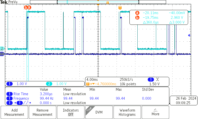

About 27% of GPIOTE events were missed
I use NRF52833 with nRF5 SDK 17.1.0 and reference examples/ble_peripheral/ble_app_uart/ for my development.
I am using the GPIOTE interrupt for ADS1292R DRDY pin. The DRDY pin will be low in frequency 250 Hz.
My setup for the GPIOTE interrupt is:
static void gpiote_init(void)
    ret_code_t err_code;
    err_code = nrf_drv_gpiote_init();
    nrf_drv_gpiote_in_config_t in_config = GPIOTE_CONFIG_IN_SENSE_HITOLO(true);
    in_config.pull = NRF_GPIO_PIN_PULLUP;
    err_code = nrf_drv_gpiote_in_init(ADS1292_DRDY_IN_PIN, &in_config, ADS1292R_drdyHandler);
    nrf_drv_gpiote_in_event_enable(ADS1292_DRDY_IN_PIN, true);
However, I found bout 27% of GPIOTE events were missed.
Anyone can help. Thanks!
Best Regards,
Terry

  • Hi Edvin,
    27% missing was determined since the time for getting 125 samples was about 635ms (expected 500ms).
    I added a debug GPIO signal at the START and END of ADS1292R_drdyHandler(). It only took about 360us as shown in the attached image.
    Also, you can find there are missing events.

  • Hi hmolesworth,
    Then, when/where will you read the data? At main loop? At timer interrupt?
  • Following  's example, you can check the mAfeSampleDataReady status in your main loop, and initiate the reading of data from there. This way, you will not be blocking your interrupthandler by doing this in the interrupt itself.
    Edvin
  • As Edvin suggests, read in main loop; keep in mind the main sleep loop is woken as a result of the ADS interrupt, so just check the flag. Perhaps add some protection for missed interrupt or ADS1292 streaming fail, since clearly at 250 samples/sec there should be an interrupt every 4mSec; if nothing for (say) 15mSes or whatever longest blocking interrupt such as flash writes takes then attempt to fix:
