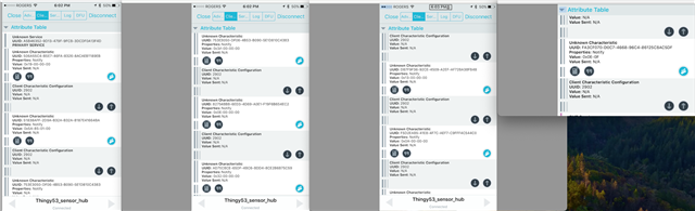

    Here are the screenshots from nRF Connect for Mobile (iOS) connected to the Thingy:53 running Sensor Hub application:
    Thingy:53 Sensor Hub project:
    https://github.com/nordic-tiago/thingy53_sensor_hub

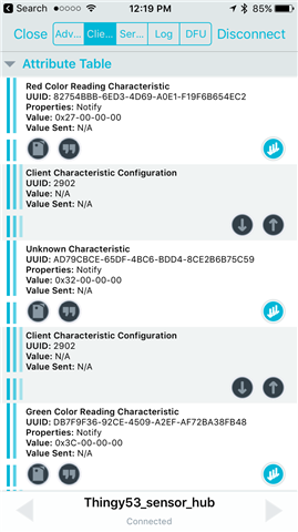

    I can now see the names for the sensor characteristics when connecting to Thingy53 using the nRF Connect for mobile.
    All names are in except for IAQ that Is still showing as "Unknown Characteristic".
        { "name": "Thingy:53 Sensor Hub Service", "identifier": "com.nordicsemi.service.thingy53_sensor_hub", "uuid": "A5B46352-9D13-479F-9FCB-3DCDF0A13F4D" , "source": "nordic"},
        { "name": "Thingy:53 Sensor Hub Temp", "identifier": "com.nordicsemi.service.thingy53_temp", "uuid": "506A55C4-B5E7-46FA-8326-8ACAEB1189EB" , "source": "nordic"},
        { "name": "Thingy:53 Sensor Hub Pressure", "identifier": "com.nordicsemi.service.thingy53_pressure", "uuid": "51838AFF-2D9A-B32A-B32A-8187E41664BA" , "source": "nordic"},
        { "name": "Thingy:53 Sensor Hub Humidity", "identifier": "com.nordicsemi.service.thingy53_humidity", "uuid": "753E3050-DF06-49334B53-B090-5E1D810C4383" , "source": "nordic"},
        { "name": "Thingy:53 Sensor Hub Red Color", "identifier": "com.nordicsemi.service.thingy53_red_color", "uuid": "82754BBB-6ED3-4D69-A0E1-F19F6B654EC2"  , "source": "nordic"},
        { "name": "Thingy:53 Sensor Hub Green Color", "identifier": "com.nordicsemi.service.thingy53_green_color", "uuid": "DB7F9F36-92CE-4509-A2EF-AF72BA38FB48" , "source": "nordic"},
        { "name": "Thingy:53 Sensor Hub Blue Color", "identifier": "com.nordicsemi.service.thingy53_blue_color", "uuid": "F5D2EAB5-41E8-4F7C-AEF7-C9FFF4C544C0" , "source": "nordic"},
        { "name": "Thingy:53 Sensor Hub Battery Voltage", "identifier": "com.nordicsemi.service.thingy53_battery_voltage", "uuid": "FA3CF070-D0C7-4668-96C4-86125C8AC5DF" , "source": "nordic"},
        { "name": "Thingy:53 Sensor Hub IAQ", "identifier": "com.nordicsemi.service.thingy53_iaq", "uuid": "AD79CBCE-65DF-4BC6-BDD4-8CE2B6B75C59" , "source": "nordic"},
    Could you please ask the nRF Connect dev team to add the entry for IAQ as well? Thank you.

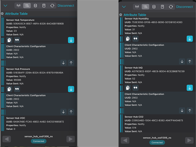

    The nRF5340 sensor hub IAQ Is showing as "Unknown Characteristic".  Could you please ask the nRF Connect for mobile team to add an entry for it? Thanks.
