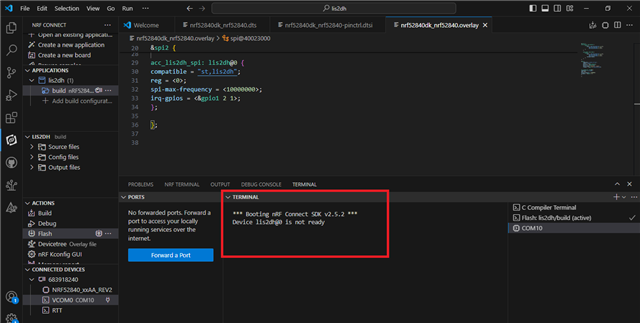

LIS2DH12 device is not ready issue
I have added .overlay file as below mentioned

And I am facing issue is
Device LIS2DH is not ready with nrf52840dk.
So, can you please, help me with it.

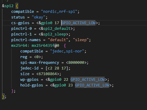

    You have to use pin ctrl when you add the pins, for example in the JESD216 sample:
    And the board file for nrf52840dk_nrf52840-pinctrl.dtsi
    regards
    Jared

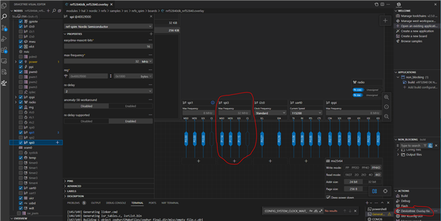

    Thank you for your response, I have one doubt about pin connections now I have to provide the pin connections according to the LIS2DH12 and nRF52840 pins. So, I have to change the pins If I am using JES2D16 reference sample but I do not have schematic of LIS2DH12+nRF52840 pin connections, I searched for it in Nordic website but i did not find it.
    If you have schematic of LIS2DH12+nRF52840 pin connections schematic, can you please, share with me.

    I provided the previous sample so that you can see how you should setup miso, sclk, and mosi using pinctrl. The CS pin is setup as a node by itself in the SPI node structure. I'm not sure what schematic you're asking for. The LIS2DH12 is not embedded on the nRF52840 DK. What pins have you physically connected the LIS2DH12 to the nRF52840 on?
    regards
    Jared

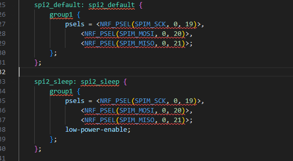

    I am connecting the pins as below mentioned in .overlay file, can you please, find this below.
    8306.nrf52840dk_nrf52840.overlay
    Can you please, find connections between LIS2DH12 sensor and nRF52840 module connections.
    LIS2DH12 JP2 header pins------------------------->nRF52840 pins
    JP1.1 PIN(VDD)------------------------------------------------->VDD
    JP2.22PIN(SDO)------------------------------------------------>P0.20
    JP2.21PIN(SDI)-------------------------------------------------->P0.21
    JP2.20PIN(SCL)------------------------------------------------->P0.19
    JP2.19PIN(CS)--------------------------------------------------->P1.12
    JP2.14PIN(INT1)------------------------------------------------->P1.02
    JP2.13PIN(GND)------------------------------------------------->GND
    After giving connections like this, I am getting this error as mentioned below marked in red color.
    So, can you please help me with this, Your help is more appreciable.

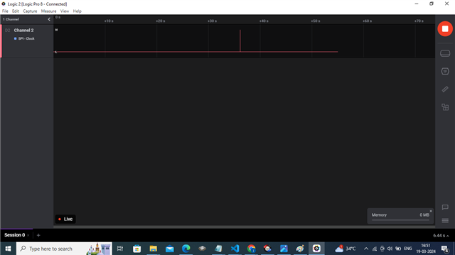

    If you probe the SCLK, and then restart you program. Do you see any activity on the SCLK pin when the system initialize? Sometimes the driver tries to initialize the slave during init, if the slave doesn't respond then it might result in your error message,
    regards
    Jared
    I am getting this waveforms without connecting any pins and after connecting by pressing the reset button i am getting one clock like this below.
    i think it will not work by connecting my spi SCLK, MISO, MOSI and CS pins are p1.15,p1.14,p1.13 and p1.12 pins as per my schematic these are configured in spi3 in .dts file by using these pins and p1.02 as interrupt pin i have configures then also it is showing device is not ready only pin configurations I am suspecting because if hardware fault of sensor then it will show device is not found but device lis2dh12 gets found but not ready. So, in my .overlay file configuration only I am suspecting.
    That doesn't look like a SCLK signal.
