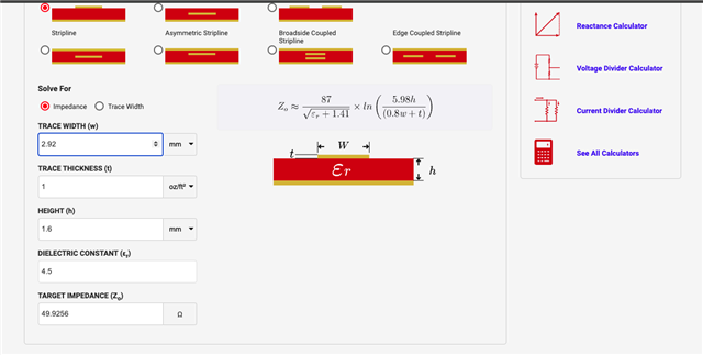

Hi, I am new to PCB design, so I want suggestions for my designed PCB. Please review it once and provide feedback upon that. I am making this PCB to use this with Thread and matter-related products. I have used EasyEda to design the PCB and used the reference designs provided by Nordic.

  • I have tried to tune the trace of Antenna as well to 50 ohm , please verify that as well
    1. The first capacitor in the matching network should only be grounded to the centerpad, it should not be connected to the rest of the GND layer directly.
    2. It seems that there is a stump, in the matching network, you should remove this.
    3. You need a full matching network the chip antenna.
    4. You need 4x4 vias in the centerpad.
    5. Much more vias in general to stich the GND layer together.
    6. The transmission line does not look like 50 ohm.

  • Hi Jared, Thanks for the reply,
    Sorry, but I am not well in understanding the terms that you have used to describe my issue. would please clear bit more in simple.
    1- It should be grounded with centerpad - what does this mean, it is a two-layer PCB?
    2- What does stump mean. ?
    5- Much more vias in general to stick the GND layer together - mean Top and Bottom layers? , and I need to give more vias to connect the ground of the Top and Bottom layers of the copper area?
    6- The transmission line does not look like 50 ohm.  How do you guess that, although I have tried to tune it as I have attached the screenshot, is that incorrect?
    It's a guess ,I have not measured it. But if you have based the dimensions on by calculating it to be 50 ohm then it's ok.
