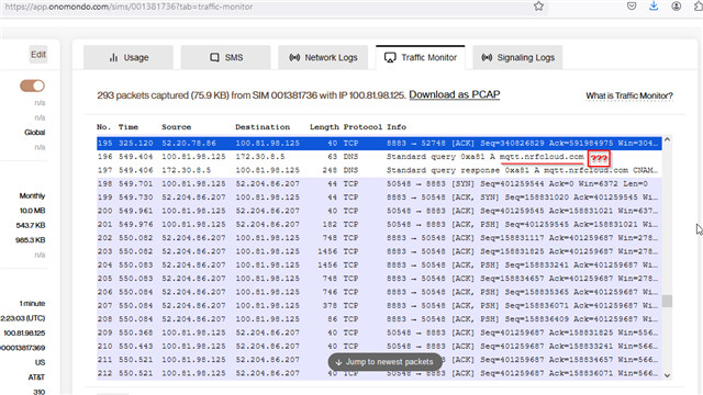

asset tracker v2: MQTT input error: -128 , have thing group with policy.
I am trying to run the asset tracker v2.
I have completed the setup steps and configuration.
Can you please let me know what to do ?

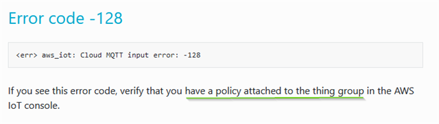

I have read that the -128 error is associated with
I have also attached the policy to the certificate

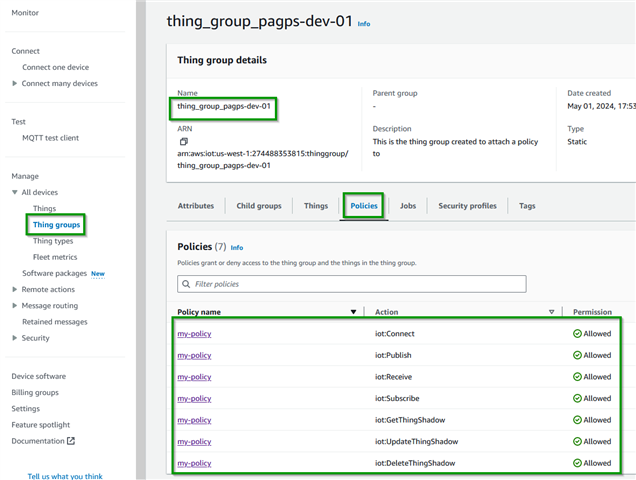

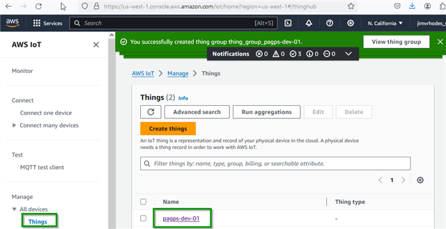

The following is the AWS Console and what I have configured:
This is the actual JSON Policy:

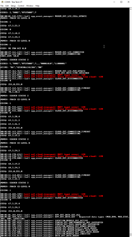

This is the serial output
