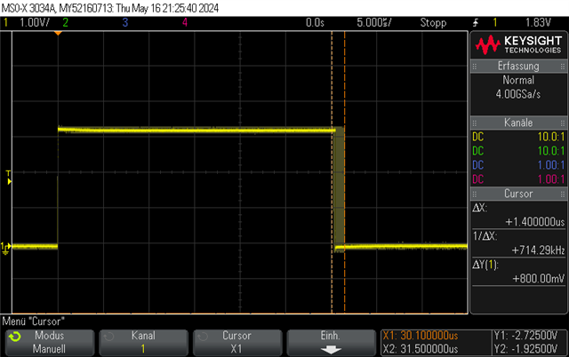

I tried to route the LFCLK (32kHz LFXO) on a GPIO similar to the method that has been described here:
 How to output 32768Hz external crystal LFCLK at a GPIO pin?
When I run the code on the nRF52832 everything works fine, i.e. I get the proper 16384 Hz signal without jitter.
But when I run the same code on the nRF52833, I get a signal that jitters with ~1.4us which leads to a frequency between 15873 and 16612 Hz.
  • In both cases, the external LFXO is running.
  • It doesn't matter if the SoftDevice is running.
  • It seems that the issue only occurs when the application toggles additionally other GPIO(s).
Do you have an explanation for this behavior? Why does it only occur on the nRF52833?

  • Thanks for your answer. We could verify that the jitter only occurs when the application toggles also other GPIOs.
    But it doesn't occur on the nRF52833-DK. So, it seems that we have some kind of corss-talk on our own HW.
