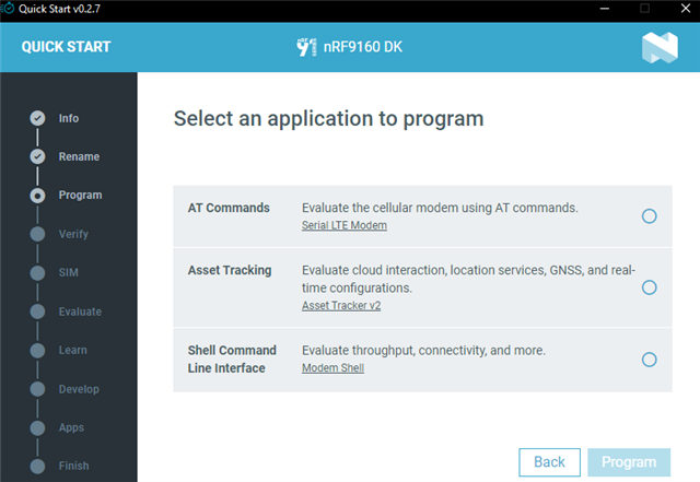

  • Hi Elaine,
    Which application do you use on your nrf9160-dk? How did you flash it (which tool did you use)?
    Dejan
  • For the trace file above, we manually installed the firmware. We used the Cellular Monitor application and connected to the serial terminal via that interface
    Can you confirm that you use nrf9160-dk board and modem firmware version 1.3.6?
    Which of the cellular samples or applications have you flashed to your board? How did you flash this application to your board?
    Can you provide more information about Nordic nrf9160 User Guide document with AT commands which you showed in your initial post? Did you make it yourself or you took it from some documentation page?
    Dejan
