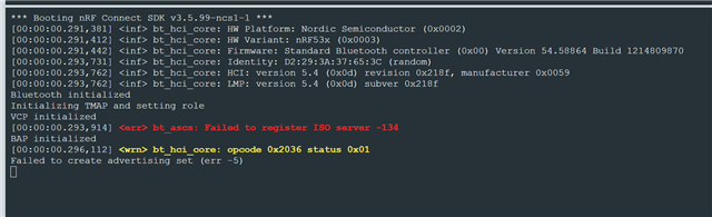

I was able to build and flash the code, but the board is not advertising and throws the below shown error.

    Your specific error is ENOTSUP, that is: the controller does not support the requested feature. I suspect that this is because the SoftDevice Controller only supports ISO for multirole devices. See the full list of supported features for the SoftDevice Controller here: https://docs.nordicsemi.com/bundle/ncs-latest/page/nrfxlib/softdevice_controller/README.html.
    Let me know if you need more assistance with finding the correct Kconfig symbols to enable the needed features in the SoftDevice Controller.

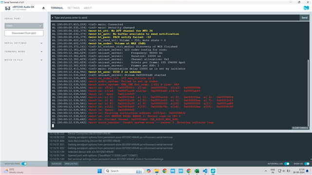

    I did work with nrf5340_audio sample. The device got successfully connected with my mobile, but when I streamed audio, the below errors were displayed

    I’d love for the board to function like an earphone, allowing me to stream audio and make calls from my phone. From what I understand, the TMAP profile would be perfect for this application.
    Could you please assist me with this?

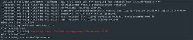

    I have some update regarding TMAP example, I added child image folder to the TMAP folder, built the code and reflashed my board. This is what I get
    The ISO error still persists.
    The device advertises, and I am able to connect to my mobile. But I am unable to control volume and stream audio.
    Can you please help me with this? does it have something to do with Kconfig symbols?
