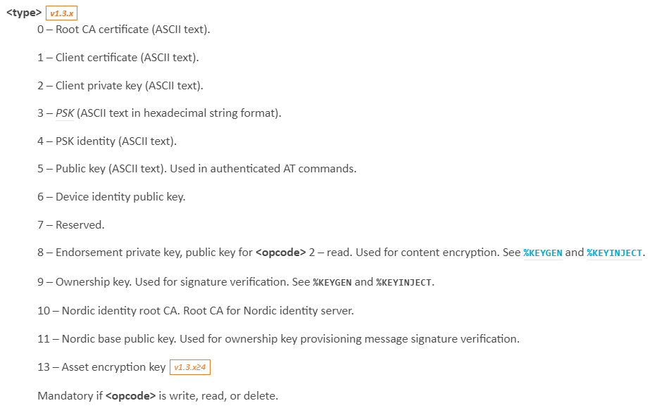

  2. I've got 3 files named "cert.pem" "chain.pem" "privkey.pem" provided by server side colleague (I assume these are CA file, CC file and PK file).
    However when I import them into SLM with cellular monitor tool, no matter if I feed CA only / CA + PK / CA + CC + PK, AT#XMQTTCON always returns "ERROR"(Any method to found reason of error?).
    As I'm surfing trying to find some solution, I noticed that some company requires user to turn .pem files into one-line format before feeding them. So does \r and \n needed to remove before feeding my certificate file into SLM?
    (Connection to MQTT port success, but connection to MQTTS port with <sec_tag> returns ERROR
  3. I've noticed there are a command AT%KEYGEN. But I'm not sure if I need to use this and how do I use this.
    As mentioned in question 1, do I have to generate a private key per client by it self or can it just use the same PK file as server?
    If it is a must to generate a private key by each client themself, is this the correct command I should use?
