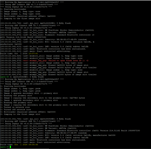

I tried to do BLE DFU with nRF7002DK referring to Lesson 8, but I cannot write to the external flash memory.
<err> mcumgr_img_grp: Failed to open flash area ID 1: -2
Also, the Device Manager app is giving me the error 'n must be >= 0'.

    CONFIG_NCS_SAMPLE_MCUMGR_BT_OTA_DFU cannot enable DFU for nRF7002DK with SPI external flash, so nRF7002DK requires the SPI-relevant configs for app and mcuboot to use SPI external flash. To enable Simultaneous DFU for app and net core, it needs to enable these configs.
    Your uploaded project also enables serial DFU configs. That makes the thing complex and hard to fix the issues, so I remove them and only make your project able to BLE DFU without issue. dfu_ble_nrf7002_modfied.7z
    You will see the error: "Failed to open flash area ID 1: -2". The error is that the mcumgr drivers try to open mcuboot_primary_1, which is in simulated RAM-flash. And this can not be opened as such. See my colleague's explanation in this post.

    I have verified that the network core is able to DFU in the sample project. First write the legacy advertise firmware to the evaluation board and then rewrite it to the extended advertise firmware with DFU. I confirmed that it was rewritten properly.
    There is one thing I am concerned about. I am getting some error messages in the log.

    [00:02:20.760,345] <inf> mcuboot_util: Image index: 0, Swap type: none
    [00:02:20.760,833] <inf> mcuboot_util: Image index: 1, Swap type: none
    [00:02:20.760,864] <err> mcumgr_img_grp: Failed to open flash area ID 1: -2
    [00:02:21.784,637] <inf> mcuboot_util: Image index: 0, Swap type: none
    [00:02:24.048,187] <inf> mcumgr_img_grp: Erased 0x29000 bytes of image slot
    [00:02:24.148,681] <inf> mcumgr_img_grp: Erased 0x1000 bytes of image slot trailer
    [00:02:42.364,868] <inf> mcuboot_util: Image index: 1, Swap type: none
    [00:02:45.181,182] <inf> mcumgr_img_grp: Erased 0x2a000 bytes of image slot
    [00:02:45.281,677] <inf> mcumgr_img_grp: Erased 0x1000 bytes of image slot trailer
    [00:02:54.092,102] <err> mcumgr_img_grp: Failed to open flash area ID 1: -2
    [00:02:54.092,773] <inf> mcuboot_util: Image index: 1, Swap type: none
    [00:02:54.094,696] <inf> mcuboot_util: Image index: 0, Swap type: none
    [00:02:54.095,642] <inf> mcuboot_util: Image index: 1, Swap type: perm
    [00:02:54.095,672] <err> mcumgr_img_grp: Failed to open flash area ID 1: -2
    [00:02:55.727,355] <inf> mcuboot_util: Image index: 0, Swap type: none
    [00:02:55.729,339] <inf> mcuboot_util: Image index: 0, Swap type: perm
    [00:02:55.730,285] <inf> mcuboot_util: Image index: 1, Swap type: perm
    [00:02:55.730,316] <err> mcumgr_img_grp: Failed to open flash area ID 1: -2
