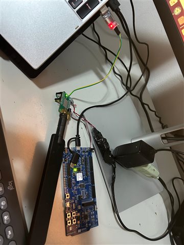

Sporadic Reboots During Idle Mode on nRF9160
I am using a Mikroe development board with the nRF9160 to establish an LTE connection and send MQTT messages to a broker. The application successfully connects to the network, establishes the MQTT connection, and sends messages with a 60-second interval between each message. During this interval, the RRC (Radio Resource Control) mode enters Idle.
However, I am experiencing sporadic reboots when the modem is in Idle mode. These reboots happen irregularly, sometimes after a few minutes or even hours. Here’s a sample log:

As you can see, the application boots again after some time when the modem enters Idle mode. This occurs intermittently, and I haven’t identified a clear pattern.
My questions are:
  1. What could be causing these reboots, particularly when the modem is in Idle mode?
  2. Is it normal for the application to restart if there's an issue with the modem?
  3. How can I debug this issue and pinpoint the cause of the restarts? Are there specific steps or diagnostics I should be focusing on?
Any insights or advice on how to address this would be greatly appreciated!

  • I am now using a 5V, 1A power supply with a step-down converter to achieve a 3.3V output.
    I briefly adapted your code into my main source, and here is the output I got:

    Could this still be happening because of a power supply issue?
    ◆ RESET_POR
    #define RESET_POR   BIT(3)
    #include <zephyr/drivers/hwinfo.h>
    Power-on reset (POR)
  • If you have doubts, add a logging statement at line 100 and print the "cause". If that's 0, it's a POR. And ensure, that you not hwinfo_clear_reset_cause and then read it again ;-). The times in the log itself after booting are not that useful. Maybe you enable the "serial terminal" to add times, if possible (I use linux/GTKTerm, which offers that).
    If that verifies, that you read 0 as reset cause, then it's a POR.
    Do you use a custom board? Do you have the capacitors close to the modem? Do you supply both VDD and VDD_GPIO from the regulated 3.3V output (you may, up to a certain voltage, supply VDD direct and only VDD_GPIO via the regulated output)?
    I'm not sure, why a POR happens in Idle. I would guess, it's triggered by a wakeup.
    Anyway, I guess you have some ideas to investigate.
  • Thank you for your reply.
    As you mentioned in the previous conversation #331671, I am using too a Mikroe LTE IoT 4 Click. I reviewed the schematic and compared it with the one provided in the datasheet, and everything seems correct.
    The strange part is that sometimes my application enters a restart loop, while other times the restart can take hours to happen. For instance, yesterday, the system restarted every 10 seconds and sometimes it’s not happening anymore.
    When a run my application, i got the output:

    The reboots don't return the code mapping.
    I ran this code earlier today, but no reboot occurred like now.
    I observed that when I use a 5-second interval between messages, reboots occur very sporadically. On this case, the modem doesn't go into RCC Idle.
    My setup is:
    Let me know if you'd like any further adjustments!

  • I didn't recognize, that the other ticket is yours as well.
    LTE/NB-IOT connection with MIKROE LTE IOT 4 CLICK
    The good news:
    My MIKROE LTE IOT 4 click runs stable over weeks.
    I guess, your wiring and so the power supply is the issues.
    For my experiments I found a USB + power supply board, which works well (see my last comment in the other ticket).
    I also send you a private message. If you like, just exchange ours apps and see, how they work on the boards.
