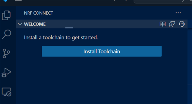

    The extension is loading, but i can't install the toolchain anymore.
    Right now something in my vscode or nrf installation seems to be broken. Its irrelevant which folder i open or what project is beeing used, i am unable to install the nrf toolchain using vscode. Open for debugging tipps in that regard.

  • My apology. I thought you have issue getting VS Code working with anything at all on Ubuntu 22.04 LTS. I see now that I have misread and also misunderstood whichever information I correctly read.
    While it is still a different topic, I do have a quick answer: The nRF Connect for VS Code extension, as of now, doesn't officially support WSL, so I recommend you to not use the extension for the WSL environment.
    If you need a Linux environment on a Windows machine, and want to use the VS Code extension, please consider a virtual machine.
