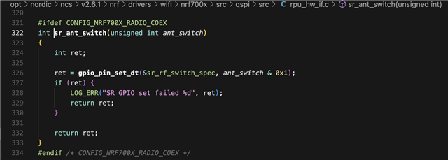

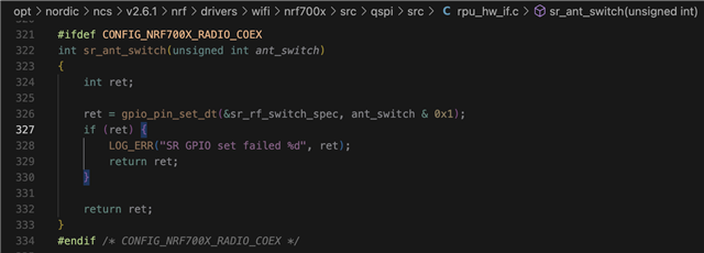

When we try to run the standard radio tests for bluetooth, we get really low power compared to what is expected (difference of about 32db). Turns out SW_CTRL0 was driving high by default even though there is no WiFi connection and we are not operating Wifi tests simultaneously (although CONFIG_NRF700X_RADIO_TEST is enabled).

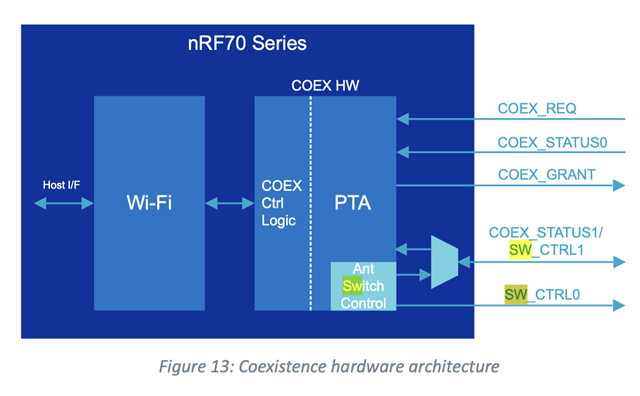

From the nRF7002 v1.2 spec, page 23 has a note saying:
The behavior of SW_CTRL0/1 is programmable and dependent on the configured coexistence mode and switch control interface.
In that case, how can we switch SW_CTRL0 to low for the bluetooth tests?
