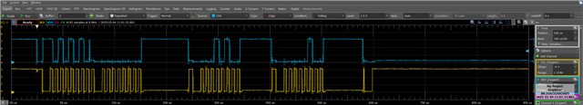

nRF52840 on PC10056 dev board operating as an I2C controller with a target that uses clock stretching while operating at "standard speed" (100kHz).
nRF Connect SDK v2.7.0-5cb85570ca43
Dev kit has DETECT (shield detect) pulled low to enable the onboard pull ups.
I note that there are quite a few semi-related previous posts, however the threads contain a lot of conjecture and hand waving. None that I have found really get to the bottom of the issue or have a viable solution.
This issue has come up on pre-production hardware as an intermittent bug, I have replicated it on the dev kit to avoid distraction about hardware. However this is problem in a mature project with considerable NRE behind it.
Issue observed
When reading from the target (and possibly in other transactions) with i2c_write_read_dt() the TWIM occasionally produces a significantly shortened clock pulse after the target stretches the clock. I have observed this in particular on first clock after a stretch, after the controller has sent an ack in response to a byte from the target. I suspect I have seen it elsewhere, however, that was before I appreciated what I was looking at.
The shortened clock is of varying length down to 1.2us, when optimistically measured at the first observable change in the trace. In practice, after considering thresholds for high and low, it ends up in the region of 850ns from the point of view of the target in a practical design.
In this case, the target disregards clock periods under 4us. A feature that mitigates the effect of noise on SCL. Not an unreasonable margin of 20% from the expected 5us clock period.
If there is any doubt about this being a feature, I have seen the lack of this feature in other targets cause no end of headache during compliance testing. An example result being a locked up bus during ESD testing.
It is also of note that even if the bus had no capacitance and the pull ups were magic resulting in no rise time, the clock pulse is still only 1.2us.

Working on the principle that this is the issue documented in errata 219 is highly likely to be the same thing, I tested the workaround provided with the FREQUENCY value scaled to match the context of 100kHz. This does not resolve the issue. Even with the clock speed reduced to ~12kHz the TWIM is producing clock pulses at ~1.2uS.

    "TWIM supports clock stretching performed by the slaves. The SCK pulse following a stretched clock cycle may be shorter than specified by the I2C specification."
    So it is a known issue, and it occurs regardless of the baud rate, unfortunately.
    FYI, it is also present on the nRF54L15, as well as the nRF52840 (and the rest of the nRF52 series. It is the same SPIM peripheral).
    I was not aware until now, but this means that it is not compliant for clock stretching, according to the I2C standard. I am sorry.

  • Looking at the trace supplied above, it appears that rather than a shortened clock pulse following the stretch what is happening is that a phantom (variable-width short) clock pulse is appearing since counting this shortened pulse there are 10 clock pulses not the expected 9 clock pulses.
    Assuming for the moment that this is indeed happening, an auxiliary clock could be spoofed by filtering out any pulse less than (say) 1.5uSecs providing a clean clock to the external device. At 100kHz or less it may be possible to set the filter such that the now-delayed clock to the slave does not push out the SDA return beyond the sample point. Using external hardware gating the unwanted short pulse can be removed with little delay on the spoofed clock so fewer worries about sampling point timing.
    Spoofing such a clock may be possible without external gates using just the internal PPI/GPIOTE with a timer for the output spoofed clock which resets the count on a short clock pulse and therefore does not trigger that short clock pulse bur triggers just the normal-width clock pulses. The width of these pulses is controlled by a 2nd timer, no software or interrupts required.
