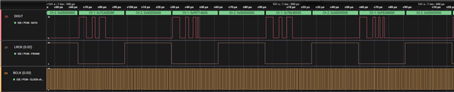

As I use the logic analyzer to read the microphone DOUT pin, I do see the data coming out. However, there is something wrong on the receiving end at NRF52832.
The error I am receiving is -11 that means timeout on read.
Kindly guide what could be at fault here.
