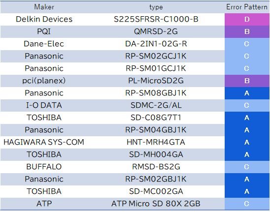

I am writing you to inquire about following questions about nRF5340.
We are using Laird BL5340 and SDK2.3.0 for our product.
While attempting to write data to SD card, we found in some SD card nRF5340 provide error in initial sequence.
We confirmed four error cases depending on the type of card.
We obtained the waveform and the error log when the error occurred.
Please find the attached ppt.
Could you think of anything that might have caused it?
Besides, are there any way to fix this problem?
SDcard initial err.pptx
    From what I can tell, in all of your screenshots, it seems like it is the MISO signal that is misbehaving, is that correct?
    So do you have any working SD Cards? And in the cases where it fails, does all cards of that type fail? Or only some? Only one?
    Edvin
  • Thank you for your reply.
    Yes.
    I have put the working SD card list just in case.
    We have checked about 366 SD cards and 16 of 366 could not work correclty.
    Here is the list of cards that can't work.
    As we described we can sort them out into 4 error patterns.
    All cards are tested under SPI access mode.
    A: MISO is PullDown, even before initialization.
    B: “Illegal Response“ returns as a response of CMD59, not for CMD8.
    C:  “Illegal Response” returns as a response of CMD8 two times.
         CMD10 and CMD9 sent even when ACMDA41 =01(Initialize undone).
    D:  CMD0~CMD9 has been succeeded, but it can’t read data as a response of CMD17.
    It seems to be that there are some problems with SPI initialization flow in SDK.
    Would it be possible to help to find out problem of the issue?
    #In my previous e-mail, we have attached the log provided by SDK just in case.

    DELKIN DEVICES	DDMSDG200032
    ダダンドール	DDMS032G01
    GAUDI	CRGMSDHCU1A16G
    ELECOM	MF-NMRSD02G
    What I don't understand is that the issue is always related to the reply from the SD card reader, meaning that either the issue is from the SD Card reader itself, or it is an issue in the SD card (SD card worn out?).
    Or do you mean that there is an issue in the SD card libraries?
    Edvin
  • What I am asking you is about the behavior of nrf5340, and we would like you to consider revising SDK.
    We think this is the issue for both nRF5340 SDK and SD card itself.
    We are currently talking with each SD card maker with this report and let Nordic know the feed back afterward.
    Is it possible to talk with SDK development team directly?
    # we will also post this issue on Git just in case.
    Yes. It would be interesting to see Zephyr's take on this. From our perspective, we don't (directly) provide SD card readers nor SD cards, but SPI. And in general, we can only directly change what is present under the "nrf" part of NCS, not whatever is coming from the zephyr part of the SDK. I see that you are pointing at some specific values in the MISO of the SPI communication. I don't know the details on the driver on that level (and it is not written by us, so I wouldn't know who to direct you to).
    1: Do you know why they respond incorrectly?
    2: Do you have any suggestion on what the drivers should do in these cases?
