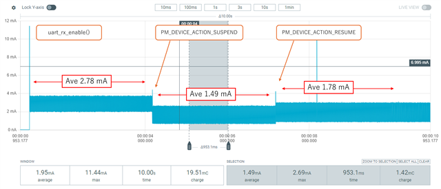

As the title says, I am suspending the UART using PM_DEVICE ACTION_SUSPEND, but the power consumption is not decreasing significantly.
With CONFIG_SERIAL=n and no UART used, power consumption is now around 20uA.
When using pm_device_action_run, the power consumption was about 1.3mA.
Please tell me the correct way to stop UART.

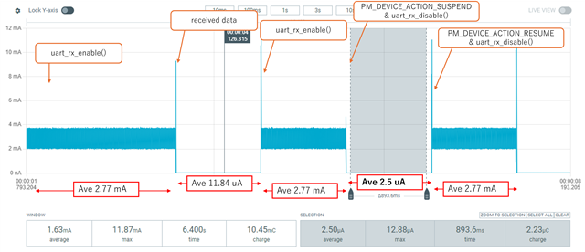

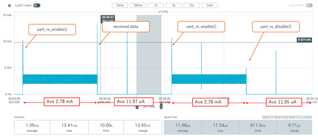

  • Using the uart_rx_disable() function or receiving data to disable the UART RX has significantly reduced power consumption.
    Using the uart_rx_disable() function alone does not yet disable GPIO, so PM_DEVICE_ACTION_SUSPEND was also used to reduce power consumption to the ideal value.
    The power consumption results for each pattern are shown below.
    pattern 1 : use PM_DEVICE_ACTION_SUSPEND
    pattern 2 : use uart_rx_disable()
    pattern 3 : use uart_rx_disable() & PM_DEVICE_ACTION_SUSPEND
    The source code is shown below.
        if (!device_is_ready(Uart))
            LOG_ERR("device is not ready");
            return 0;
        const struct uart_config cfg = {
            .baudrate = 1000000,
            .parity = UART_CFG_PARITY_NONE,
            .stop_bits = UART_CFG_STOP_BITS_1,
            .data_bits = UART_CFG_DATA_BITS_8,
            .flow_ctrl = UART_CFG_FLOW_CTRL_RTS_CTS,
        int err = uart_configure(Uart, &cfg);
        if (err)
            LOG_ERR("uart_configure (%d)", err);
            return 0;
        err = uart_callback_set(Uart, Callback, NULL);
        if (err)
            LOG_ERR("uart_callback_set (%d)", err);
            return 0;
        err = uart_rx_enable(Uart, Buffer, sizeof(Buffer), 1000);
        LOG_INF("uart_rx_enable (%d)", err);
        k_msleep(1000);
        err = pm_device_action_run(Uart, PM_DEVICE_ACTION_SUSPEND);
        err = uart_rx_disable(Uart);
        k_msleep(1000);
        err = pm_device_action_run(Uart, PM_DEVICE_ACTION_RESUME);
        LOG_INF("uart_rx_disable (%d)", err);
        k_msleep(10);
        return 0;
    The above code works, is this method correct?
