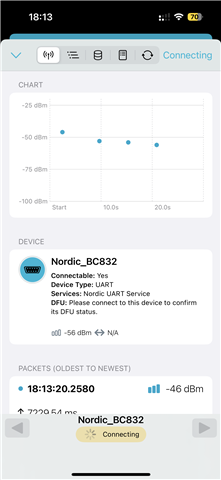

I am trying to program the BC832 (https://www.fanstel.com/bt832-1) using the NRF52DK (NRF52832). BC832 is a Bluetooth Low Energy (BLE) 5.3 with NFC module using Nordic nRF52832 SoC. A chip antenna is integrated.
I followed the wiring instructions provided in this link: https://devzone.nordicsemi.com/f/nordic-q-a/55203/programming-external-board-bc832-with-nrf52840-dk.

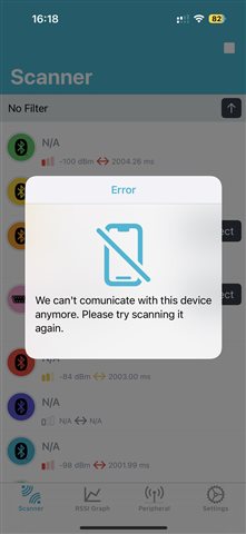

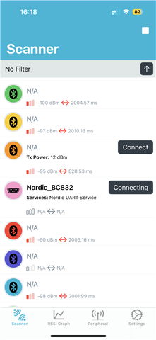

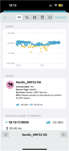

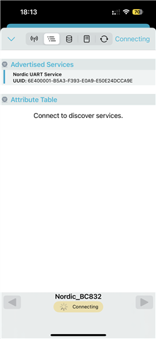

The result is that I can see the device name in NRF Connect, but it does not display signal strength (dBm) or connection latency (ms), and I am unable to connect to the device.

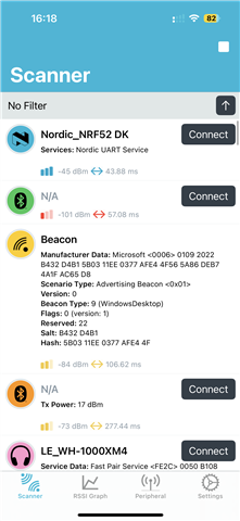

However, when I use the same code to program the NRF52DK, I can successfully connect to it in NRF Connect, see the signal strength and connection latency, and execute my intended commands.

  • Sloppy low-frequency clocks are fine for advertising but useless for a BLE connection. There is no 32kHz crystal fitted to this module (unless you added one) so these definitions (which assume LF crystal) are incorrect:
    // <h> Clock - SoftDevice clock configuration
    // <o> NRF_SDH_CLOCK_LF_SRC  - SoftDevice clock source.
    // <0=> NRF_CLOCK_LF_SRC_RC
    // <1=> NRF_CLOCK_LF_SRC_XTAL
    // <2=> NRF_CLOCK_LF_SRC_SYNTH

    Rather than messing around trying to fix this I usually add the following at the top of sdk_config.h:
    #define NRFX_CLOCK_CONFIG_LF_SRC         0
    #define CLOCK_CONFIG_LF_SRC              0
    #define NRF_SDH_CLOCK_LF_SRC             0
    #define NRF_SDH_CLOCK_LF_RC_CTIV        16
    #define NRF_SDH_CLOCK_LF_RC_TEMP_CTIV    2
    #define NRF_SDH_CLOCK_LF_ACCURACY        1 // <1=> NRF_CLOCK_LF_ACCURACY_500_PPM

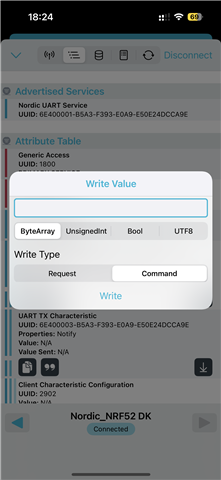

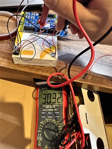

    Currently, I am trying to send commands to change the voltage levels of pins 12 and 13 on the BC832. I used a multimeter to measure the voltage on these pins, and after sending the 01 and 02 commands, the measured voltage remains around 100mV. I am powering the BC832 via the VDD_nrf pin on the NRF52 DK, so theoretically, I expect the voltage on pins 12 and 13 to be around 3V when the corresponding commands are sent.
    To troubleshoot, I tried running the same code directly on the NRF52 DK, and I was able to change the voltage levels of pins 12 and 13 successfully using nRF Connect. The measured voltage was around 3V as expected.

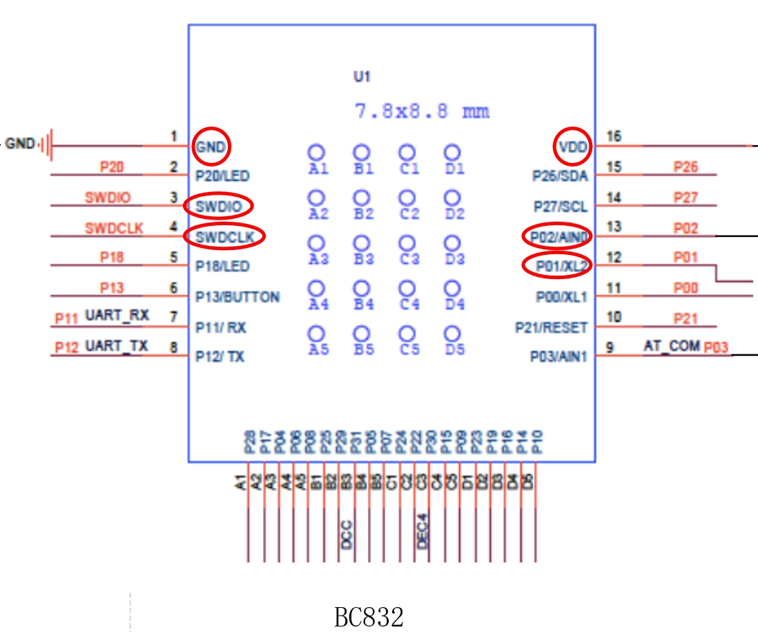

  • Pin 12 (P0.01) may be set to the external crystal mode though pin 13 (P0.02) should work. One assumes you are using P0.01 and P0.02 and not P0.12 and P0.13?
    12 P01/XL2  C7 P0.01 GPIO, connection for 32.768kHz crystal
    13 P02/AIN0 C6 P0.02 GPIO, Analog input 0

     BC832_V2.01_Dec-2017.pdfHere are the pin assignments and datasheet of BC832.
    After configuring Pin 12 (P0.01) and Pin 13 (P0.02) for GPIO functionality, I noticed that nRF Connect is unable to scan for BC832. I suspect this might be due to a conflict with BLE functionality, as Pin 12 (P0.01) is being used for GPIO instead of connecting to the external crystal oscillator required by BLE.
    To address this, I plan to use PIN 9 (P0.03) and Pin 12 (P0.01) for GPIO high/low transitions, keeping P0.01 available for BLE connectivity. However, even after making this change, I’m still unable to scan and detect BC832.
    Here is the project on SES now:ble_app_uart_bc832 - cannot scaned.zippath:"\ble_app_uart_bc832\pca10040\s132\ses"
    And here is the previous project where the BC832 could be detected, but pins 12 and 13 could not toggle voltage:ble_app_uart_bc832 - detected.zip
    Could this issue still be related to the crystal oscillator configuration, or am I missing something else critical? Thank you again for your time and expertise!
