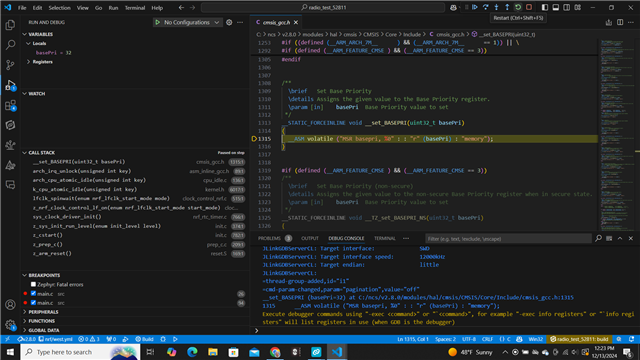

Testing the RADIO TEXT example on 52811.

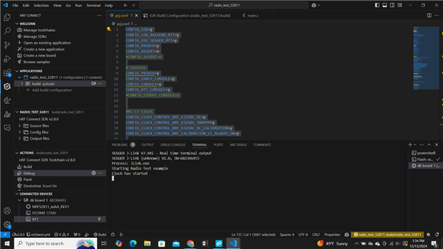

1. 52811 is not a supported target - so I must select all targets then the unsupported dts (nrf52840/nrf52811)
2. I add a Build, with the included prj.conf, optimize for size and use sysbuild.

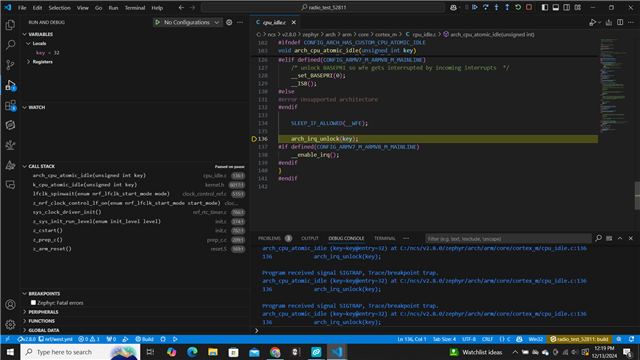

3. Build and Debug.
4. Code Halts at:

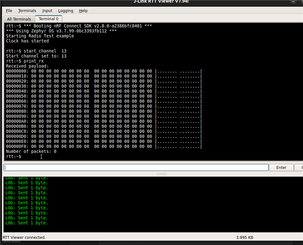

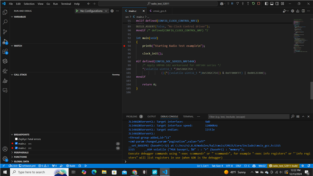

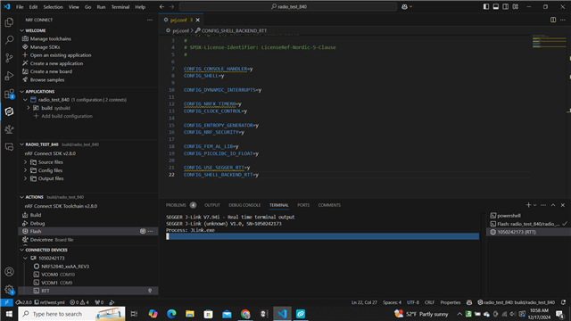

This compiles, loads, and runs to a break in main.
I can connect RTT, and I get the expected Console Out.
