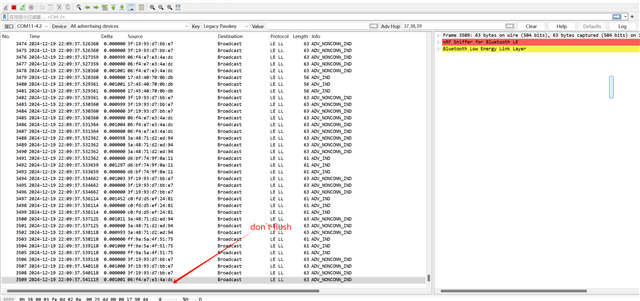

The latest 4.1.1 firmware has the problem of stopping sniffing after a few seconds

As shown in the figure, when le coded phy is set, theoretically the data on wireshark will be refreshed continuously, but in fact, it will stop automatically after several seconds of refreshing, and the indicator on dongle will also stop flashing

I have sniffing coded PHY working on my end using the GUI (there seems to be issues from the command line, though). However, there may be issues if you have the old Python extcap plugin, so please remove that and install using nrfutil install ble-snifffer and nrfutil ble-sniffer bootstrap.
