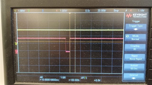

  • Thank you Andrew for your reply.
    I seem to have found the cause of the problem although I have no idea why this happens:
    Please consider the following sequence of events:
    - 2 GPIOs (P0.11 and P0.26) are configured as pullup
    - 2 GPIOs (P0.11 and P0.26) are configured to sense low
    - 2 GPIOs (P0.11 and P0.26) latch is cleared
    - sd_power_system_off() is called
    - After 10 seconds the P0.26 pin is pulled low by an external RTC (latch is triggered)
    - For some reason P0.11 is also pulled low and so latch is also triggered
    This happens only if the J-link RTT viewer is connected ?!
    When the viewer is disconnected the GPIOs behave as expected:
    Maybe you can shed some light?
    Tsahi
