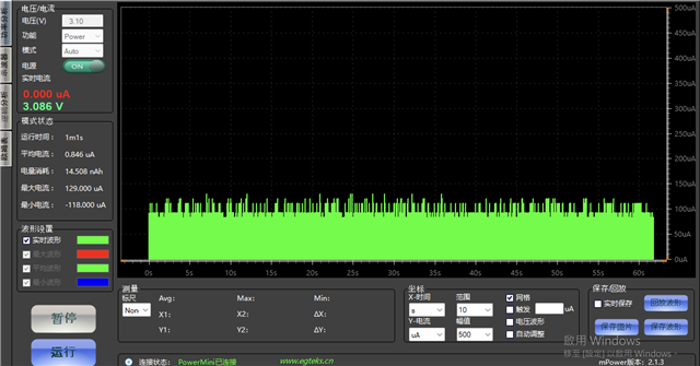

Hello~
I am developing nrf52840 with zephyr ncs tool chain v2.7.0 and SDK v2.6.1.
Our hadware is very simple, just a power IC, a nrf52840 and a G-sensor.

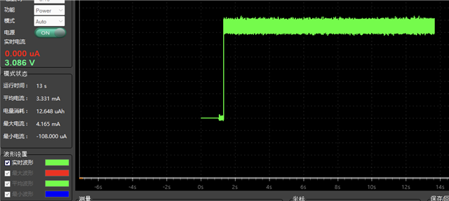

Our pre-production PCB average current is 600uA when normal operating. We want to minimize it to around 120uA (This is the estimate current value we get from here:  Online Power Profiler for Bluetooth LE  )
When normal operation, without scan, with advertising and sleep 100 ms in main loop. And we  turned on ADC, I2C also.
And when normal operation, G-sensor is off.
We turn on DCDC also.
This is our Device tree, we had turned off all unused function blocks.

This is power management settings in our project:
CONFIG_PM_DEVICE=y
CONFIG_PM_DEVICE_RUNTIME=y
CONFIG_POWEROFF=y
CONFIG_PM_CPU_OPS=y
CONFIG_BOARD_ENABLE_DCDC=y
Do you have any ideas on "how to minimize operating current to 120 uA " ?
