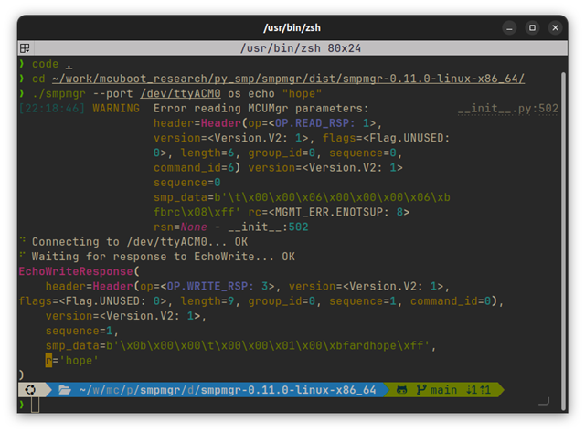

    With the smpmgr at the moment i get the following responses when in "mcuboot". Whereas I've had no luck communicating with the smp_svr..wtih mcumgr
    The warning seems to say that the client failed trying to read MCUmgr parameters. You could try enabling this: CONFIG_MCUMGR_GRP_OS_MCUMGR_PARAMS.

    I will now attempt on sdk nrf v2.9.0 (i'm hoping later is bettter) to implement with config_mcumgr_grp_os_mcumgr_params. I will keep you posted.
  • Okay - Update is as follows.
    Created a very simple program as per
    https://docs.nordicsemi.com/bundle/ncs-latest/page/nrf/applications/nrf_desktop/doc/dfu.html
    Using version 2.9.0
    Added the  CONFIG_MCUMGR_GRP_OS_MCUMGR_PARAMS to the prj.conf.
    I can run the smpmgr and we are partially cooking.
