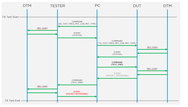

I had to use another device to send BLE packets for RX test. What I have seen is the BLE receiver shows accumulated packets if I keep sending packets form the TX device. For example, when I send 10 packets, I can see the RX device shows 10 packets, but when I send another 10 packets, then the RX shows 20 packets and so on. Is it what I should see from the receiver?
This is common behavior as the receiver accumulates the total count of received packets from the moment the test starts until TEST_END.
''The PC starts the test by setting up the DUT in receiving mode and the TESTER to transmit packets. The test parameters, including the frequency, packet length and packet type, must be matched between the TESTER and DUT. Otherwise, the test fails. At the end of the test, TEST_END is sent to the TESTER to stop the transmission and then to the DUT to stop reception. The DUT responds with the total number of packets received.''
source (+) Fast Production Screening based upon Bluetooth DTM - Blogs - Nordic Blog - Nordic DevZone
