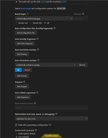

    We do not want to update FW via Bluetooth. We are updating FW via serial interface using our own protocol. The problem we are facing is assert fail on the first FW boot after update. Our example project demonstrates that assert fail occurs even without FW update procedure. All we have to do is erase entire memory, write fresh image to the memory and upon the first boot assert failure occurs. However this can be reproduced only if BT settings are enabled for reasons unknown to us. Despite the fact our example code does not use any BT functionality. Assert failure upon the first boot is the problem we are trying to resolve.
    Please note in order to successfully build our example project our devicetree overlay file must be included and "use sysbuild" must be set. Please see build configuration picture attached.

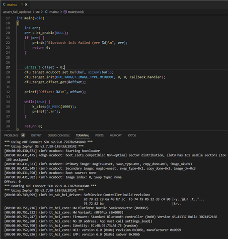

    I am not sure if they are the same issue causing the assert or not. There are two Devzone cases (this and this) with the "[handler != ((void *)0)]" assert, but they are caused by different issues. For your upload project, it can be fixed by adding the following code:
    	int err;
    	err = bt_enable(NULL);
    	if (err) {
    		printk("Bluetooth init failed (err %d)\n", err);
    		return 0;
    Here is the test project : assert_fail_updated.7z

    Do you get any issues while running the new image without issue before updating?
    Your suggestion helps to eliminate "assert fail" problem in both cases, our example project as well our main project. Thank you.

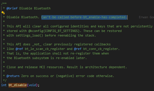

    Calling of bt_enable() at the beginning of main() solves assert fail on the first boot. Could you please clarify if calling bt_enable() would not increase power consumption in case we are not using BT functionality?
    In order to be sure of minimum power consumption we call bt_disable() immediately after bt_enable():
    However we found a comment in bluetooth.h file, which states that bt_disable() can only be called after bt_enable has completed:
    Does it mean we should wait for a callback to confirm bt_enable has completed before we call bt_disable() or is it not necessary?
