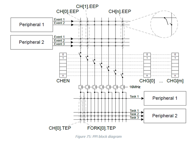

  • Hi Andrew,
    Could you let me know the frequency of your input signal ?
    You can read more about the clock that the PPI align to:
    So there can be up to one clock cycle delay.

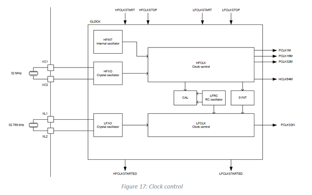

  • Hi Andrew,
    You can take a look at the Clock Control section in the spec:
    The HFCLK clock control receive the oscillation either from the external 32MHz crystal or the internal HFINT. It then output the PCLK16 16 Mhz to the peripherals.
    You can choose to start the HFXO or leave it to the HFINT (default)
    When there is a peripheral that requires PCLK16 then the HFCLK will be kept active.
    snoopy20 said:
    How about the GPIOTE, how fast does it react to the PPI event?
    Actually it may take up to 2 cycles for the GPIOTE task to output on GPIO pin.
    You can take a look at this ticket:
     gpiote event -> ppi -> gpiote task latency
    and this ticket:
    Delay from GPIOTE Event until a Task is started over PPi on nRF52
    Seems that the latency needed is about 380ns (from GPIOTE IN event to GPIO output)
    You can try to set NRF_POWER->TASKS_CONSTLAT = 1; to switch to constant latency mode, but I don't think it would reduce the latency in your case, as the COMP should keep the HFCLK running all the time.
    I'm already running TASKS_CONSTLAT = 1;
    I'm not using GPIOTE IN event for this part of the system (though it is in use elsewhere, but I assume doesn't effect the output of a GPIOTE channel).
    So if PPI takes 1 cycle and GPIOTE takes 2 cycles @ 16MHz that's 16/3 = 5.3MHz
    Which is close to the 5MHz "normal" mode of the COMP. Given that the behaviour is random sometimes taking minutes and sometimes hours I think there's another cycle being taken somewhere. Or maybe the 5MHz for the COMP is a ballpark figure not an absolute. It's a little close for comfort so I think the reason is potentially established.
