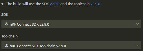

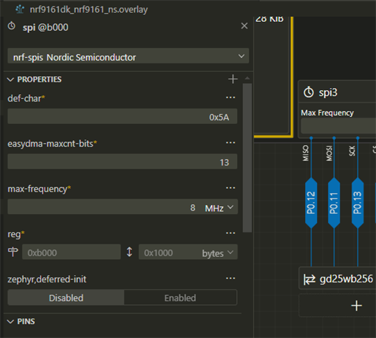

     I'm using VS Code with all the extensions (and I have all the programs available already downloaded and up to date on my computer). I'm using nrf Connect SDK v2.9.0 and nRF Connect SDK Toolchain v2.9.0 for building the project. As I read somewhere on the internet, not only I have to configure master/slave in the main.c file, but also I do have to select the correct driver in spi3 module to make each board work as Master or Slave. Using the driver spim I have found no problem so far, everything works fine and builds, and it also detects both my module spi3 and my gpio0. So far, I could not get spis (reading in this paper I kind of understood it as the driver needed for the Slave to work as a Slave, I have attached the PDF where it stands everything on this boards to know.
    nRF9161_PS_v1_0-3439621.pdf
    However, when I try to use the spis driver:

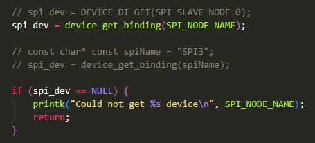

    The build works fine, as spim (the one I think is used for master boards), but once I flash the program to the nRF9161 DK board, I get a debugging message I created to check if the spi3 drivers has been recognized (if so, it should be working). But  it seems that "spi_dev" in my code is pointing to NULL (meaning it has not recognized properly the spi3, basically the board is not working at all). Here is a photo on the debugging message shown in the console:

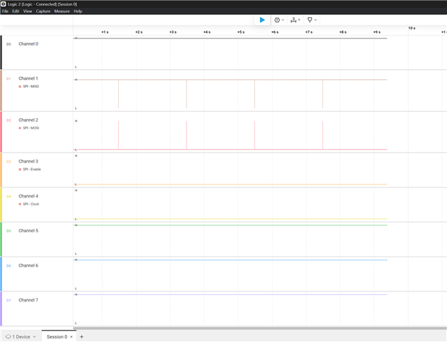

    I do have a Logic Analyzer, but it shows nothing useful to me but this:
    As far as I know here, clock and enable signal are not working, they may be colliding one with each other (meaning the Master and Slave both are trying to transmit Clock and Enable signal). But, the main problem I think is that the Slave is not recognizing the driver, and I'm not making it work as a Slave (I think master works just fine, but I'm not quite sure about it).
