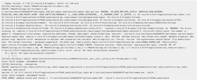

Broadcast sink setup using nrf5340, facing build errors
Attached error log snippet for the reference.

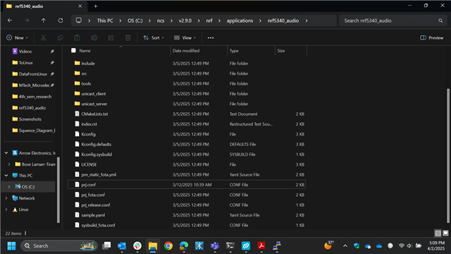

  • Please make sure that you have the following files in the nrf5340_audio folder:
    Also, please share your CMakeLists.txt as the error mentions this file is not present.

    I just noticed one thing.
    When you build, first navigate to the nrf5340_audio folder, i.e.
    right now you are doing the 3rd step of west build from the c:/ncs/v2.9.0 location, but you need to do the 3rd step from this location:
    c:/ncs/v2.9.0/nrf/applications/nrf5340_audio
    Please try from this location and you will be able to build.
    -Priyanka
  • Facing below build error while running on the provided path:
