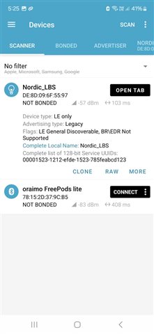

    Sorry for the late reply but I used a spectrum analyzer to make sure there was a signal being transmitted and I actually could see some peaks temporarily in the 2.4 to 2.5 GHZ bandwidth.
    However, the nRF52 BLE can be seen on my laptop but not via nRF connect app on my android mobile phone:
    when I tried to connect to it via my laptop, it gave me an error and I can see from the logs on the nRF52 side these logs:
    so the antenna is working but is there anything to be modified from the nRF Connect App side for such an error?

    Nevertheless, when I programmed the MCU with the Bluetooth sample example,, the mobile app doesn't detect the presence of any Bluetooth devices:
    I have this mobile app with another MCU vendor for Bluetooth connectivity (BLE 5.3), and it worked successfully, so I don't think it's the mobile app but rather the code. I can't seem to know what's wrong with the code. I am using the 32 KHZ crystal oscillator that's required by the example code. All of the functions being called in the code doesn't return any errors.

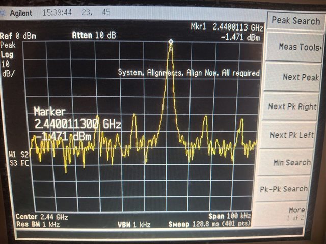

  • Looks like the radio is working at least, so that seems to be in order.
    It might be that the 32MHz clock is a bit off. Can you sett the Resolution bandwidth to 1kHz and View bandwidth to 1kHz. Then we can see how accurate the carrier signal is.
    Ideally you should have something that looks like this:
    So if the carrier offset is bad then things like this can happen.
    Jonathan

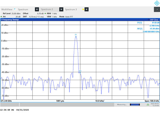

  • I have done the test and noticed the following:
    At central frequency = 2.44 GHZ and the span = 100KHZ -:
    At central frequency = 2.44 GHZ and the span = 1MHZ -:
    At central frequency = 2.4403 GHZ and the span = 100KHZ -:
    Note that I didn't remove a 0.8pF capacitor on the ANT pin Side, meaning that the ANT pin is connected directly to the spectrum analyzer, and the 0.8pF capacitor is connected between the ANT pin and the ground.
