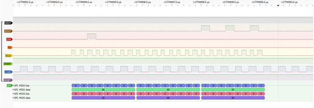

  • FYI, I have some clarification and proof about the multibyte delay:
    9.5.2.9: ADS129x Datasheet
    However, if SCLK is 4 MHz, one byte is transferred in 2 µs. Because this transfer time exceeds the tSDECODE specification, the processor can send subsequent bytes without delay. In the second scenario, the serial port can be programmed to use multiple byte transfers instead of the single-byte transfers required to meet the timing of the first scenario.
    I have scoped the ADS1298 PDK running using the TI evaluation software.
    The attached image shows the PDK outputting a two byte command read and getting a response whilst using a 4MHz clock. The need to run with a 4* t_CLK space is not required. I would assume that the ADS129x spi rx register can still receive spi data but cannot act upon the next byte received within 4* t_CLK, this clarifies this section.
