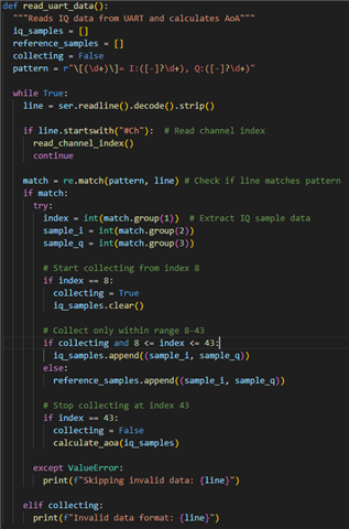

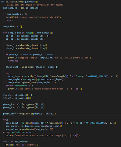

I'm working on an indoor positioning system using an nRF5340 and a CHW1010-ANT1 antenna array. I'm receiving IQ samples from BLE CTE packets and using them to calculate the AoA.
When I manually input IQ values, the AoA is correct and stable. However, when I use live IQ samples from the receiver, the AoA values fluctuate significantly, even though the transmitter and receiver are stationary.
As I understood it, the first 8 samples are from the reference period and should not be used to calculate the AoA and the first sample to be used (at index 8) is from antenna idx 1 and not 0 since 0 is used in the reference period. So the pattern goes 0 - 0 - 0 - 0 - 0- 0 - 0 - 0 - 1 - 2 - 3 - 4 - 5 - 6 - 7 - 0 - 1 - etc. Am I missing something here?

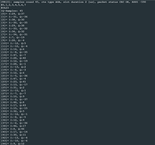

Below are some of the IQ samples I get.

IQ sample values received:
Read from UART func:
Calculate AoA func:

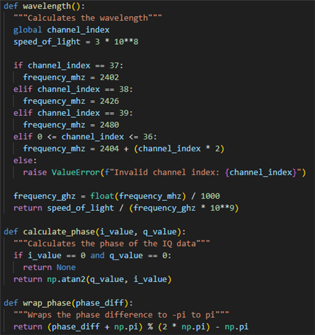

Wavelength, Phase calc, and Phase wrap funcs:
I assume that the logic is correct since manually set values are showing the correct AoA.
Grateful for any help!
    It should be used to calibrate.
    Yeah, although that depends a bit on your pattern length, and whether these numbers refer to antennas, or order to antenna pattern etc.

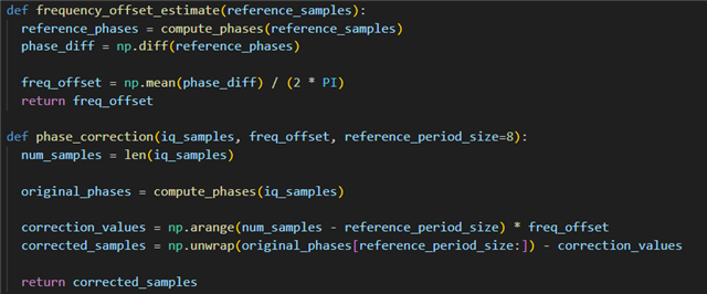

  • It should be used to calibrate.
    And would that be by getting the frequency offset from the reference samples and then using it to correct the remaining samples? If so, I'm thinking of something like this:
