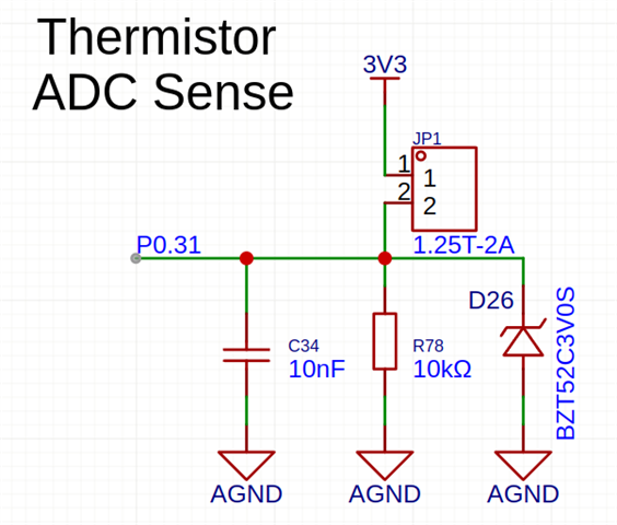

I am using a custom nRF52832 board with multiple ADC channel readings sequentially. I am trying to read thermistor (NTC) value on channel 7 and not getting accurate reading. As soon as I plug the thermistor, the value goes on decreasing/ stabilizing which goes below the actual/ anticipated reading that could be due to hardware/ software issue in my setup.
The schematic of that specific channel is:
The DTS for that specific channel is:

This is the output of channel 7 readouts after 1 sec interval:
ADC reading of device adc@40007000, channel 7: 555 = 1625 mV

The ADC reading falls/ stabilizes from 555 to 505 and I expect a value around 540 (measuring thermistor from meter then converting to raw adc value).
I have tried setting VDD and different ACQ times but didn't help.
Please suggest a solution.

  • The starting point is to know that using the internal reference provides an absolute measurement of voltage on AIN7; with a perfect internal reference and perfect ADC with no errors you get a perfect voltage measurement but unfortunately that is not what is required to measure this NTC. Should the 3.3V change by (say) 1% or have noise then that "perfect" voltage measurement will vary accordingly.
    Instead try a ratiometric measurement such that any variation in the 3.3V supply causes an equal variation in the SAADC reference voltage which largely eliminates the effect on the measured voltage. Ironically to get the best results use minimal or no capacitance on the NTC input as the AIN7 input should exactly track the noise on 3.3V rail and not be filtered; ie set the reference to other than ADC_REF_INTERNAL and test both with and without the 10nF capacitor.
    Once you have those results measure using differential mode using AIN7 and (say) AIN6 where AIN6 is connected to the lower end of the 10k. Measure twice with P AIN7, N AIN6 and P AIN6 and N AIN7. The average will give a more accurate reading with residual SAADC offset removed.

    Ok. you mentioned that you have tried different ACQ time; was the source resistance in accordance to the ACQ time?
  • Thanks for the response.
    I have tried setting the ADC ACQ time to max i.e. 40us but issue remains the same.

  • Is there anything else that I could try in the firmware? My ADC value gradually drops almost 10% then stabilizes but goes below the actual/ desired value.
    Another thing when I place AIN7 to GND, I get adc of 65515 not ideally 0.
