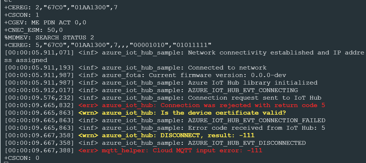

After everything is done i get this error =>
*** Booting nRF Connect SDK v2.9.0-7787b2649840 ***
*** Using Zephyr OS v3.7.99-1f8f3dc29142 ***
[00:00:00.253,784] <inf> azure_iot_hub_sample: Azure IoT Hub sample started
[00:00:00.253,845] <inf> azure_iot_hub_sample: Bringing network interface up and connecting to the network
[00:00:00.525,634] <inf> azure_iot_hub_sample: Device ID: XXXXXXXXX
[00:00:00.525,695] <inf> azure_iot_hub_sample: Host name: XXXXXXXXXXXXXXXXX
+CEREG: 2,"67C0","01AA1300",7
+CSCON: 1
+CGEV: ME PDN ACT 0,0
+CNEC_ESM: 50,0
%MDMEV: SEARCH STATUS 2
+CEREG: 5,"67C0","01AA1300",7,,,"00001010","01011111"
[00:00:05.561,889] <inf> azure_iot_hub_sample: Network connectivity established and IP address assigned
[00:00:05.562,011] <inf> azure_iot_hub_sample: Connected to network
[00:00:05.562,805] <inf> azure_fota: Current firmware version: 0.0.0-dev
[00:00:05.562,835] <inf> azure_iot_hub_sample: Azure IoT Hub library initialized
[00:00:05.562,835] <inf> azure_iot_hub_sample: AZURE_IOT_HUB_EVT_CONNECTING
[00:00:07.714,813] <inf> azure_iot_hub_sample: Connection request sent to IoT Hub
[00:00:07.798,614] <err> azure_iot_hub: Connection was rejected with return code 5
[00:00:07.798,645] <wrn> azure_iot_hub: Is the device certificate valid?
[00:00:07.798,645] <inf> azure_iot_hub_sample: AZURE_IOT_HUB_EVT_CONNECTION_FAILED
[00:00:07.798,675] <inf> azure_iot_hub_sample: Error code received from IoT Hub: 5
[00:00:07.799,896] <wrn> azure_iot_hub: DISCONNECT, result: -111
[00:00:07.799,926] <inf> azure_iot_hub_sample: AZURE_IOT_HUB_EVT_DISCONNECTED
[00:00:07.799,926] <err> mqtt_helper: Cloud MQTT input error: -111
+CEREG: 5,"67C0","01AA1302",7,,,"00001010","01011111"

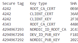

To the chosen values, this is the stuff i get from nrfcredstore COM11 list:
Secure tag Key type SHA
4242 ROOT_CA_CERT 0E0A61E2E78D28EEA66B15A9B10C1F4E5E8AD379FEA9131D02EC4A2473F9AB9C
4242 CLIENT_CERT 36AF6EF65D6EC7E800F407E7B7239301D3A359B81FC5475DED8851D87E5B6905
4242 CLIENT_KEY 2F38805AF55755FFEDFE71CC2D38C7AAA7AD20633BCA49E920796CEB768D5B8C
4343 ROOT_CA_CERT 44866CF6914A1AD1100147FA8432387FD5E63A5B5DFDD5A967A507AFEB78639B

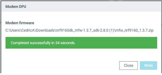

    • I opened up the Programmer via nrf connect for Desktop.
    • Clicked on Reset.
    • Then i downloaded the latest firmware (nrf9160dk_mfw-1.3.7_sdk-2.8.0) and selected the zip in the unpacked folder.
    • I clicked write.

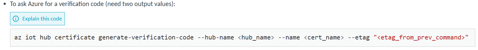

      • I uploaded the root CA "az iot hub certificate create --hub-name <hub_name> --name RandomTest --path ca/root-ca-cert.pem"
      • This results in an output with Etag, Name, certificate and so on.
      • I use the etag for the next command to get the verification code : az iot hub certificate generate-verification-code --hub-name <hub_name> --name <cert_name> --etag "<etag_from_prev_command>"
      • This results in the same kind of json with other values, i wrote down the verificationcode.

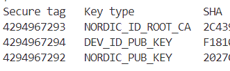

          • I then followed the instruction for "nrf91: Modem generated private key" because why not.
          • So i gathered a list of keys with the "nrfcredstore com11 list" command resulting in the desired list:
          • The 4242 and 4343 secure tags are my creation so i delete them again just to be sure resulting in this list :

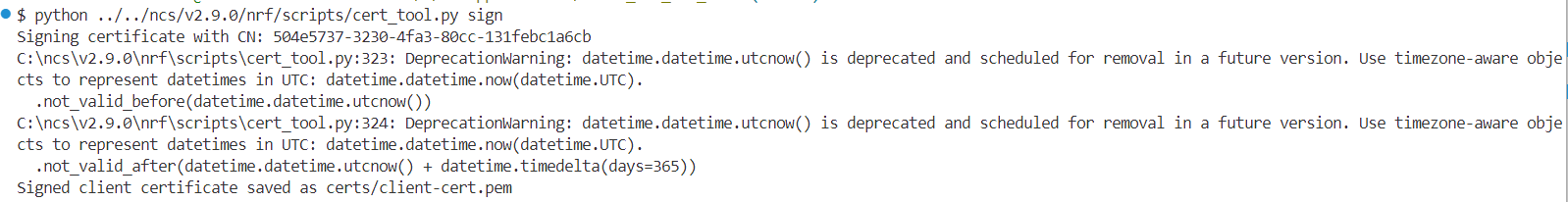

          • Then i sign the CSR (i guess because the command doesnt give it away) "Cert_tool.py sign"
            • While ignoring the useless note because it tells me that things may vary and i should see the documentation but no link is provided (could be improved).

    Cedric A. said:
    • Then i extract the CN (Whatever it is) with "openssl x509 -in certs/client-cert.pem -noout -subject". As far as i know i dont need the CN at all so i dont know why i should take note or extract it at all.
    • With the CN i combine the device certificate and the sub ca with "cat certs/client-cert.pem ca/sub-ca-cert.pem > certs/client-cert-chain.pem"
    As stated in step 6 Register a device in Azure IoT Hub, the device ID must match the Common Name (CN) of the certificate. The CN of the certificate is set to the device UUID, and the CN is read out by Azure to identify the device during the TLS handshake.
    From the output it is clear that you using modem generated and this is using a CN based on UUID
    This means that the device ID must be the UUID in Azure IoT Hub.
    Can you please test and verify?
    Øyvind
  • I used modem generated private key.
    So do i get this right ? after the step for the CN i note down the CN and create a device in azure with the CN as Device id ?
  • i just tried to redo the step of Device creation but with the twist that i use the CN as DeviceID but it did not change the outcome Disappointed
  • Hello, are you seeing the same outcome as first reported? Could you please share full logs from the last try?
