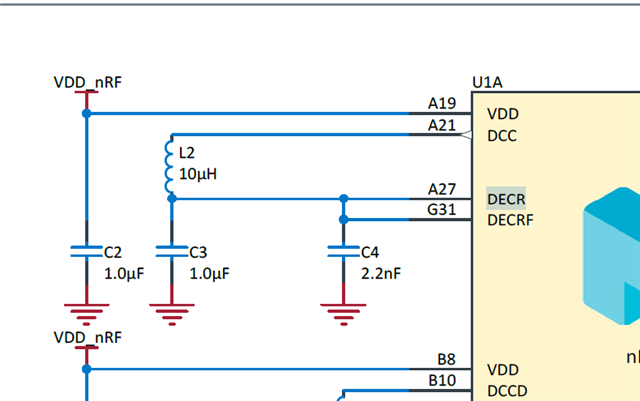

I designed a similar board asThingy53, espacially the antenna parts are almost the same, except the RF switch, we replace it with another one (BGS12WN6E6327XTSA1), then we found there is some issue to make the switch work properly, so I just removed the RF switch and short the RF output to the short range antenna, which means, now only one anntenna is connected to the RF, even so, I cannot see any RF signal on the mobile phone.

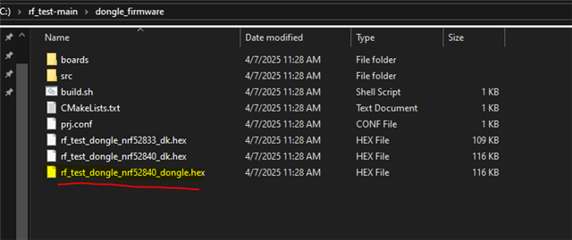

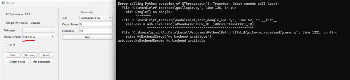

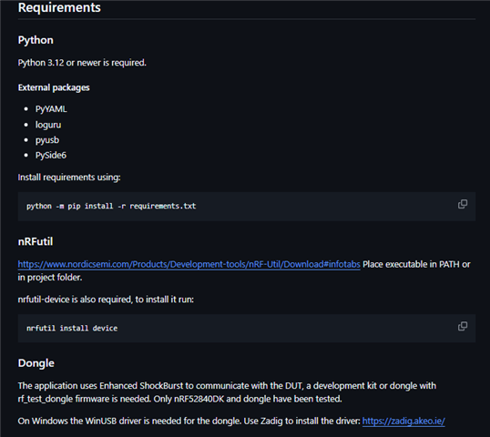

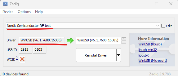

  • Hi
    thanks a lot. it seems working.
    I copied the libusb-1.0.28\MinGW64\dll\libusb-1.0.dll file in C:\windows\system32
    I also flashed the empty_app_core.hex and nrf5349.hex on nRF5340DK board.
    USB dongle and nRF5340Dk both are connected to the laptop, then start the GUI. it looks like this:
    So what's the next steps, how to perform the RF test?

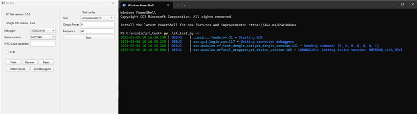

  • Hi @Bendik Heiskel
    Proud to be the very first user:)
    so what's the overall mechanism of the whole test setup?
    the python GUI (rf_test.py) controls the connected USB dongle, the USB dongle sends the "Test config" to DUT
    and this is the detected DUT, I guess:

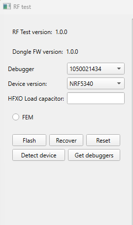

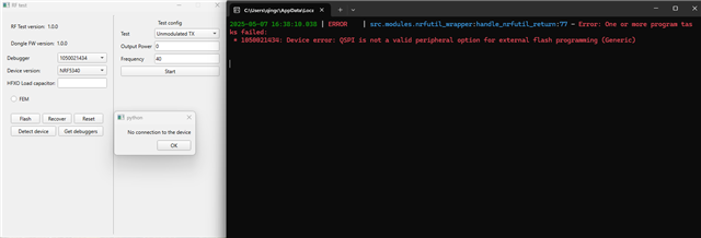

    what are these buttons used for? there is not any output except the "Flash" button, if I click them:
    is my understanding correct?

  • The main use case for this application is in our test lab for tuning customer boards. It is created in a way that there is one universal test FW for the DUT, which doesn't rely on any external serial connection.
    It has most of the functionality of the radio_test sample from the nRF Connect SDK so it can be used for the same type of testing.
    All buttons and input fields have tooltips describing the functionality and expected input, just hover over the button/input field for a couple of seconds for it to appear.
    The left side of the GUI is used for flashing the test FW to the DUT and configuring the internal load capacitors for nRF5340 and the nRF54L15.
    This looks like there could be a issue with the version of nrfutil and nrfutil-device.
    Can you run the following commands to check which versions of nrfutil/nrfutil-device you have installed:
    nrfutil -V
    nrfutil device -V
    I have tested with nrfutil version 8.0.0 and nrfutil-device version 2.10.1 which both is the latest versions, and are not able to reproduce the device error.
    You can update both to the latest version using:
    nrfutil self-upgrade
    nrfutil upgrade device
  • Hi
    yes, after upgrading the nrfutil, no errors show up again.
    "The left side of the GUI is used for flashing the test FW to the DUT and configuring the internal load capacitors for nRF5340 and the nRF54L15."
    I'm curous how this programming is done? command via UART or DFU via dongle?
    How shall I programm these firmware for DUT into my custom board? nRF connect?
    Regards
    Danny

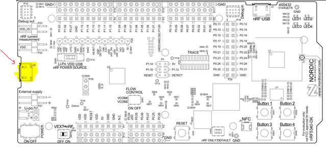

  • The programming is done using a debugger, it is just a wrapper for nrfutil. It does not do any serial of OTA DFU. When a debugger is connected, it's serial number will be shown in the debugger drop down menu. When pressing the "Flash" button the application will check which device is connected to the debugger and flash the correct test FW to it. The "Get debuggers" button can be used to updated the list of connected debuggers if a debugger is connected after starting the application.
    To program you custom board you will either need a standalone debugger, or use the debug out connector on the nRF5340DK.
  • Hi
    good to know.
    that means I need the nRF5340DK to flash my custom board.
    By the way, I just found out the issue and make the RF on my baord working.
    After double check the datasheet of nRF5340, I found that I forgot to short DECR and DECRF together.
    After soldering them togehter, now it's finally working!
