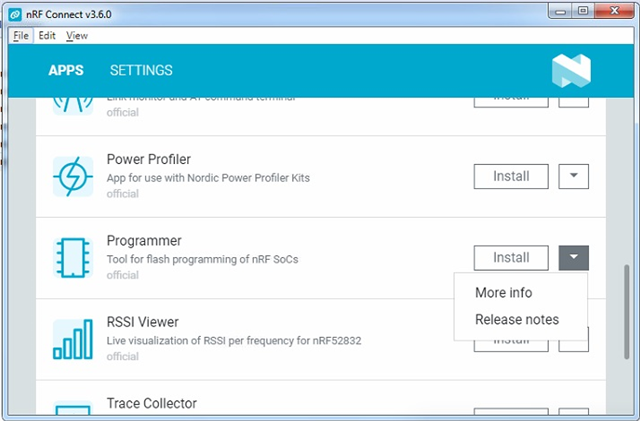

I have tried to install the nRF connect SW package on a Windows 7 32 bit system (different versions) but was not able to get the applications running. When  installing an older version of the nRF connect version "nrfconnectsetup360ia32" I could install some applications, but when starting them the message appeared that these apps only work in the updated environment.

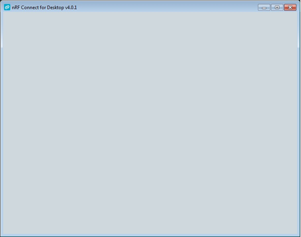

When installing the latest version "nrfconnect-setup-4.0.1-ia32" the nRF connect startup screen stays completely empty.

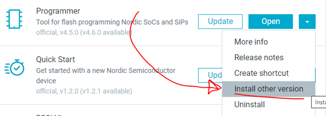

  • Could you try installing an older version of the app using this drop-down menu?
    Elfving
  • That option is not available in the drop down menu. See below:
    When pressing the install button it gives a warning that the version is not compatible and when ignoring this warning an error is returned and nothing is installed.

    EDIT: I see that installing older versions of apps where added in v4.1.0, could you see if you are able to install that version?

    Sorry for my late response but i was very busy with other projects and could not work on this one. as said before, installing nRF Connect v4.0.1 gives the following result on a windows 7 machine:

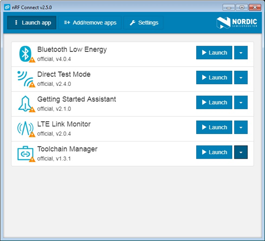

    As you can see the apps cannot be installed as the menu is not shown. Installing nRF connect v.2.5.0 is working better but the apps are not compatible anymore and are not working. See below:
    When pressing launch an error appears and the app doesn't work.

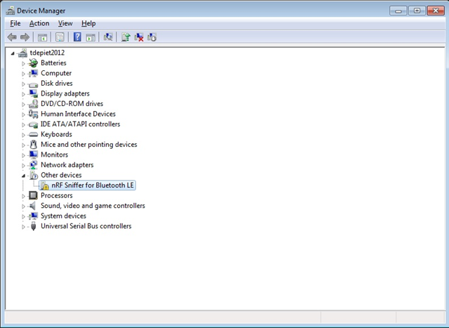

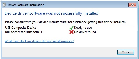

    I have installed the BLE sniffer FW on the nRF52840 USB Dongle to see if that will work but the USB dongle in not recognized in Windows 7. The USB driver cannot be found. See below:
    Can you support in getting the nRF52840 USB dongle working on the Windows 7 OS? Maybe by installing a separate USB driver or package? nRF connect SW package is not needed to run on this machine but we need to get the USB dongle working. The SW we have written to test our products is programmed on this USB dongle.
