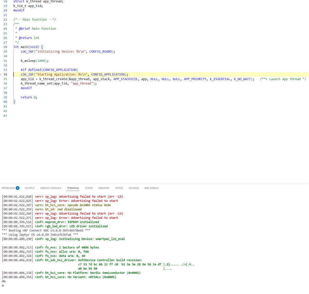

Can't get RTT working on L15 using J-Link Plus.
I can flash the chip. I can run the debugger. I can go to the connected devices, select the device, go to the little "plug" symbol on the RTT, and select it. That brings up a window asking me to select a device. I select the j-tag device, and then select the processor. It appears to work, but then when I try to run the debugger, I get this:
[00:00:00.390,843] <inf> eeprom_drvr: EEPROM initialized
[00:00:00.391,242] <inf> rgb_led_drvr: LED driver initialized
*** Booting nRF Connect SDK v3.0.0-3bfc46578e42 ***
*** Using Zephyr OS v4.0.99-3e0ce7636fa6 ***
[00:00:00.391,493] <inf> sp_log: Initializing Device: smartpac_l15_eval
[00:00:00.393,514] <inf> fs_nvs: 2 Sectors of 4096 bytes
[00:00:00.393,521] <inf> fs_nvs: alloc wra: 0, f10
[00:00:00.393,525] <inf> fs_nvs: data wra: 0, 120
[00:00:00.393,614] <inf> bt_sdc_hci_driver: SoftDevice Controller build revision:
c7 53 7d bc 06 12 f7 c0 b3 3a 3e 28 8e 56 1e d7 |.S}..... .:>(.V..
a0 be 95 b0 |....
[00:00:00.395,368] <inf> bt_hci_core: HW Platform: Nordic Semiconductor (0x0002)
[00:00:00.395,386] <inf> bt_hci_core: HW Variant: nRF54Lx (0x0005)
0m
m
And then nothing else. A colleague has repeated the process, and the RTT works fine on their system. I'm running nrfutil-device 2.11.0. The nRF connect toolchain and SDK are both 3.0.
Any thoughts?

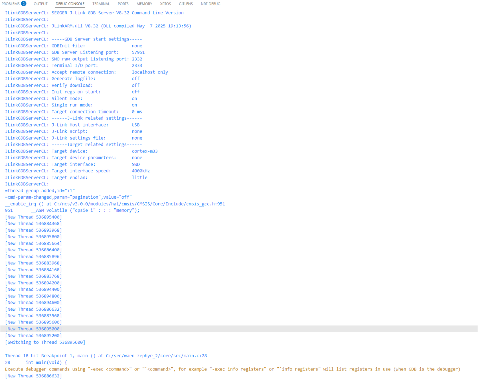

  • Hi
    I think you might be looking in the wrong place here. The RTT terminal in VS Code selects a generic M33 as the target in the gdb server, and needs to be changed to nRF54L15. Here are some images:
    Simon

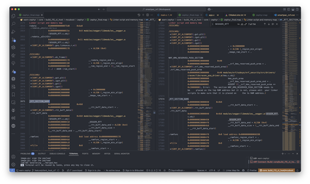

  • Hi Simon,
    We've discovered more information. The location of the RTT seems to shift around from the Boot loader to the Core. Here's a snapshot of the mcuboot and core map files. It appears that something is adding nrf_kmu_reserved_push_area to the core version, which is causing the RTT memory area to get remapped.
    We are able to use J-Link RTT Viewer to explicitly set the RTT memory, but we have to disconnect and reconnect each time we run in order to get it to work. I haven't figured out a way to make it work in the nRF Connect IDE.
    Please advise.

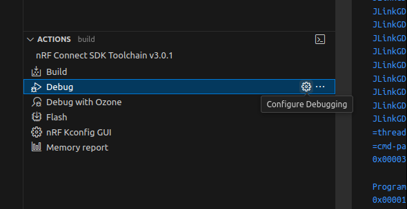

  • We have seen some success like in this thread when you add rttconfig in vscode launch config. with address set to auto. Can you give it a try?
  • I'm sorry, I'm not sure I understand. There's a launch.json under .vscode. Is that what you mean? Or is there another file somewhere that is the vscode launch config you are referring to?
    Yes,
    When you find settings for example "executable, try adding rttConfig settings as below as mentioned in that thread I linked to.
      "name": "Debug nRF54L15 + RTT",
      "type": "cortex-debug",
      "request": "launch",
      "servertype": "jlink",
      "device": "nRF54L15",
      "cwd": "${workspaceFolder}",
      "executable": "${workspaceFolder}/build/zephyr/zephyr.elf",
      "rttConfig": {
        "enabled": true,
        "address": "auto",
        "decoders": [
          { "type": "console", "port": 0 }

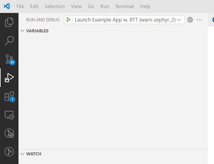

  • I think we're talking apples and oranges. The contents of the launch.json in the .vscode subdirectory are as follows:
        // Use IntelliSense to learn about possible attributes.
        // Hover to view descriptions of existing attributes.
        // For more information, visit: https://go.microsoft.com/fwlink/?linkid=830387
        "version": "0.2.0",
        "configurations": [
                "type": "nrf-connect",
                "name": "Launch the active build configuration",
                "config": "${activeConfig}",
                "runToEntryPoint": "main"
    There's no "executable." I'm using nRF Connect and Toolchain 3.0, just in case that makes a difference.

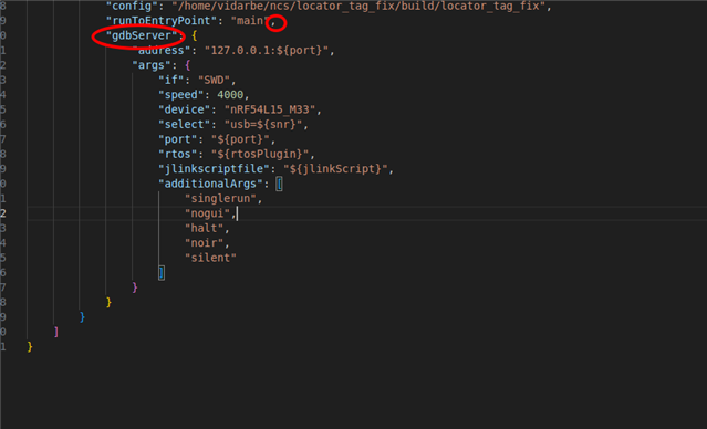

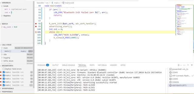

  • Hi Calvin,
    I tested RTT debugging & logging with MCUBoot + BLE and do not see the same issues with my j-link plus, with the config to the .exe that Simon mentioned earlier.
    For example, I quickly wrote a BLE application, and modified my launch executable to…
        "version": "0.2.0",
        "configurations": [
                "name": "Launch basicble",
                "config": "c:/nrf/basicble/build/basicble",
                "runToEntryPoint": "main",
                "gdbServer": {
                    "address": "127.0.0.1:${port}",
                    "args": {
                        "if": "SWD",
                        "speed": 4000,
                        "device": "${device}",
                        "select": "usb=${snr}",
                        "port": "${port}",
                        "rtos": "${rtosPlugin}",
                        "jlinkscriptfile": "${jlinkScript}",
                        "additionalArgs": [
                            "singlerun",
                            "nogui",
                            "halt",
                            "noir",
                            "silent"
    And each time I step, RTT is still printing logs as I step through
     (with a sdc assert if I sit in a bp too long, since it's a bluetooth application)
    Could you try modifying your debug configuration to see if the problem persists?
