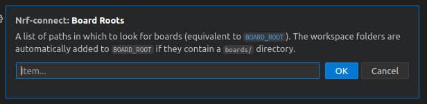

    To build for a custom board, you need to set the board root. You can set this in settings in VS Code like this:
    You can also add it as a part of the build command, e.g.:
    west build -b custom_nrf54l15dk/nrf54l15/cpuapp -- -DBOARD_ROOT=<my_board_root>
    Please note that the board root is where the 'boards' directory is located. So, if you for example have a board under /home/username/nordic/boards/vendorname/custom_nrf54l15dk, then the board root is /home/username/nordic.
