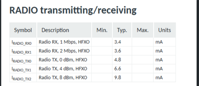

I am currently developing an nRF54L15 module.
During the evaluation, I measured the Tx current consumption and got a result that was 2mA higher than the value listed in the data sheet.
The current consumption being confirmed is IRADIO_TX2 below.
Under the IRADIO_RX0 conditions, values ​​equivalent to those in the data sheet were measured.
To identify the cause, I modified it with an nRF54l dk and tried to measure at 3.0 V to see if there was a difference.
However, since it was impossible to measure at 3.0 V, I checked at 1.8 V to see if there was a current difference between the evaluation board and the module under development.
There was no difference in the results.
It was about 21mA.
When powered at 1.8V, the current consumption is the same as that of the nRF54L15, so I believe there will be no problems with the module under development.

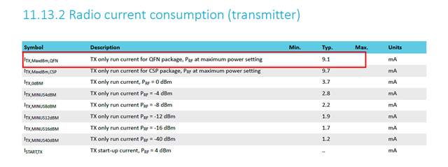

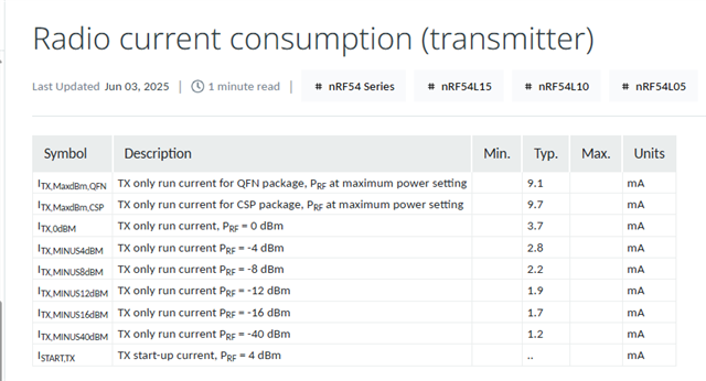

    Regarding this ''Could you tell us the environment in which you measured IRADIO_TX2'' query, did you get the screenshot from previous version of product documentation? Our latest specification looks like this
    Radio current consumption (transmitter)
    The nRF54L15 DK is using QFN, the spec 9.1 mA is from characterization on internal RF boards instead of DKs.
    Test env: 25°C,3V, DCDC mode on (that you need to set in the config file), HFXO, BLE1M, TX OP +8dBm.
    We can also test on DKs but in terms of price that is not efficient.

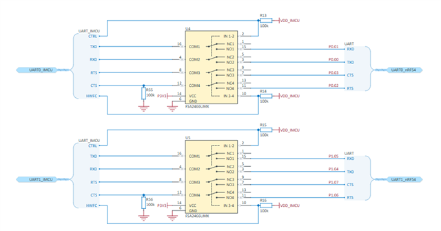

  • Hi, Kazi
    Here Set up the DK is the description of setup.
    I have checked, but do I need to remove the following parts?
    Do I need to remove U4 and U5 physically, not via a pattern?
    The above was verified using Nordic's own board so we cannot verify it, right?
    The module we are developing is different from the results in the datasheet, so we would like to first check if there are any differences with Nordic's board.
    When measured with Nordic's dedicated board, it is 9.1mA, but the Tx 8dBm listed in the data sheet below is 9.8mA. Why is there a difference?

  • Hello Hiroki,
    Can you please tell which version of datasheet you are mentioning here? This is not documented in the current datasheet.

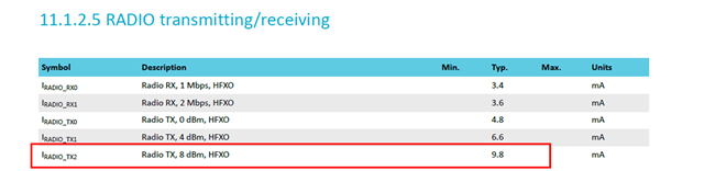

  • Hi, Kazi
    The data sheet at the following URL is used as reference. This is v0.9.
    Is this version up to date?
    https://docs.nordicsemi.com/bundle/ps_nrf54L15/page/keyfeatures_html5.html
    It is understood that the following values ​​are measured on Nordic's internal board.
    The following values ​​are typical values ​​measured under the conditions described in 11.1.1 Conditions.
    I don't understand why there is a difference in the above in the first place, so I would like an explanation.
    Also, the module we developed is far from the typ in 11.1.2.5, so could you tell me what you think the cause could be?

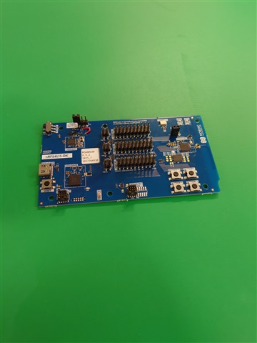

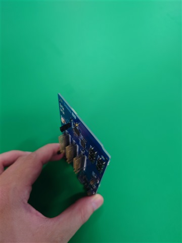

  • Hi,Kazi
    In order to quickly identify the cause of the problem, we modified the DK so that 3.0V was applied only to the nRF54l15.
    As a result, the current consumption during transmission changed depending on the nRF54l15dk's pattern antenna state.
    With pattern A, the current consumption was 12 mA.
    With pattern B, the current consumption was 9.8 mA, approaching the typical value on the data sheet.
    Also, the current consumption changes when I touch the pattern antenna.
    What causes this change in current consumption?
