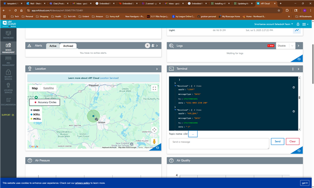

Trying to make Thingy91's asset_tracker_v2 light sensor (BH1749) data to show up in a card on Dashboard in nrfcloud.
By default asset_tracker_v2 code supporting light sensor reports it as
#define APP_ID_LIGHT_THRESHOLD "LIGHT_THRESHOLD_EXCEEDED"
But since there is no card for LIGHT_THRESHOLD_EXCEEDED
we changed it to
#define APP_ID_LIGHT_THRESHOLD "LIGHT"

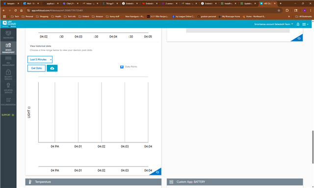

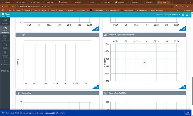

After this change - data shows up in LIGHT card, but only the event count (see attached screenshots).
We would like to see chart of timestamped R/G/B/IR datapoints,
Hence the question - how do we make it show up as a chart of datapoints with timestamps ?

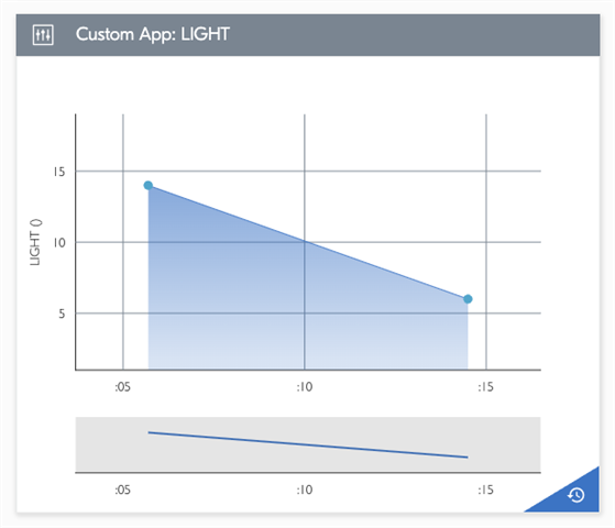

  • Hey there- I am currently looking into this to see what is possible. I should have an update for you in the next day or so.
  • The custom app cards will only show very basic numeric data points:
    The example above is populated with a data array like:
    const data = [
        appId: "LIGHT",
        messageType: "DATA",
        ts: 1751739854498,
        data: "6"
        appId: "LIGHT",
        ts: 1751739845691,
        data: "14"
    In the example you posted there are single and array based data points. This will not translate to how these custom cards work. You could try to create four different cards with an R / G / B / IR value on each card, but I'm pretty sure this is not what you're looking for. If you are trying to show whether any R/G/B/IR value exceeded a threshold, I think you would need to send it as a boolean like 0 or 1, but again, with four values I'm not sure this would be ideal as it would require 4 different cards. As of right now the display you are looking for is not supported.
