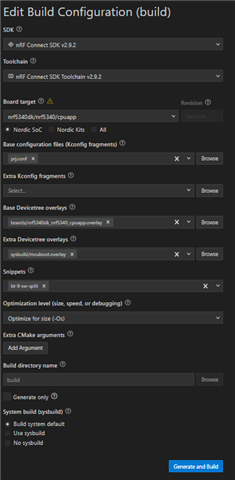

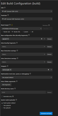

  • I added bt-ll-sw-split snippet.
    Below the west command generated by VsCode:
    west build --build-dir c:/Work/nrf-samples/hello_world/app/build c:/Work/nrf-samples/hello_world/app --pristine --board nrf5340dk/nrf5340/cpuapp -- -DNCS_TOOLCHAIN_VERSION=NONE -DCONF_FILE=prj.conf -DSNIPPET=bt-ll-sw-split -DBOARD_ROOT=c:/work/nrf-samples/hello_world
    I got the following error:
    devicetree error: C:/ncs/v2.9.2/zephyr/snippets/bt-ll-sw-split/bt-ll-sw-split.overlay:1 (column 1): parse error: undefined node label 'bt_hci_controller'
    CMake Error at C:/ncs/v2.9.2/zephyr/cmake/modules/dts.cmake:295 (execute_process):
    execute_process failed command indexes:
    1: "Child return code: 1"
