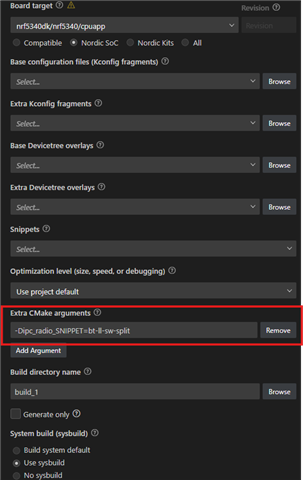

  • Hello Leiser,
    I understand the frustration. I am also trying the same here and getting a device tree error. I’m checking to see if I’m missing something in particular and also verifying internally. I’ll get back to you on this soon.
    Abhijith
    After spending a lot of time on this, I was able to make it work. I'll explain what I did here. I took a basic beacon sample from the SDK and tried enabling the Zephyr controller on it. When it comes to the nRF5340, you need to apply the controller-related snippet only to the cpunet image. See my screenshot below.
    Also, see my generated config, which confirms that the Zephyr Controller (Split LL) is enabled. You don't need to include any extra configs or overlays for this. -DSNIPPET=bt-ll-sw-split work for single core devices but not with dual core device like nRF5340.
