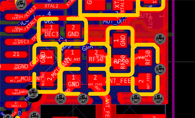

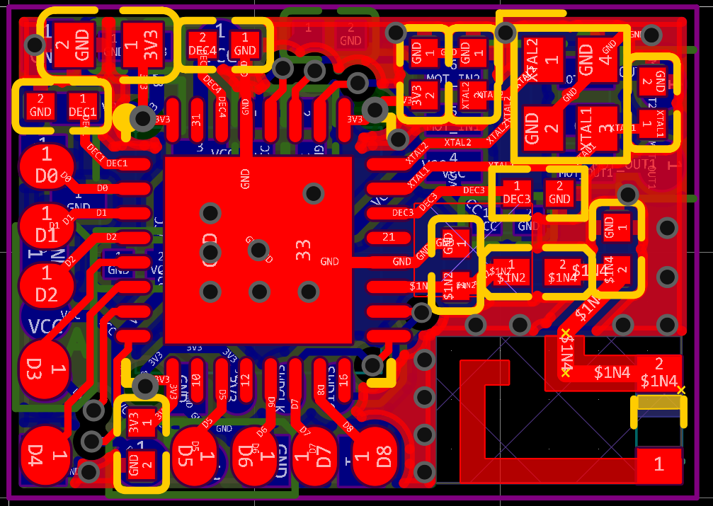

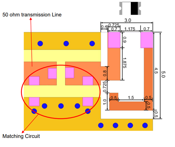

I'm preparing a second revision of my first BLE PCB with nRF52810 MCU.
The first iteration worked ok, but BLE range was worse than a ready-made module with PCB antenna. The project is a PCB to control tiny RC models, so PCB size is 10x14mm.
I used a chip antenna that can be mounted in the corner of PCB with a radiating element PCB trace. I chose it for minimal footprint required (5x3mm). Antenna impedance is stated to be 50 ohm.
RF matching part is taken from MCU datasheet.
PCB is 4 layers with GND below RF path (and another GND below that). Width of the wires inside Pi network up to antenna footprint is impedance-matched (I just used JLCPCB calculator)
schematic (relevant part)
top
inner 1

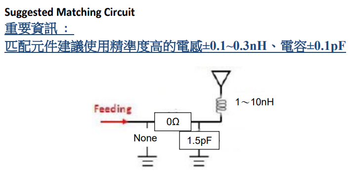

Antenna datasheet, for reference. 1-10nH inductor is required for other variants of placement (and is missing from this edge-mounted variant).
Please suggest what can be improved here. Are there any low-hanging fruits? Considering that:
1) I don't have a vector analyzer
2) PCB space is very limited, so no space for another full Pi network (in addition to existing one that matches MCU pin to 50 Ohm from datasheet). And I have no way of tuning it anyway due to p1. I added a DNP capacitor though, can place a 1.5pF capacitor from antenna datasheet there.
3) I want to stick to minimum components size of 0402.
    Apologies for the delay.
    C9 and L1 can't be used for antenna matching, these components are used for matching the impedance of the ANT to 50 Ohm, and as a low-pass filter used for attenuating the harmonic distortion. Two additional components must be added(along with C2) to make the Pi network recommended in the antenna datasheet.
    Other than this the design looks good.
    We can help with tuning the antenna, please make a private ticket requesting this when the board is produced and refer to this ticket.

  • Hello Bendik, thank you for answer! Can you suggest what's the best way to cram two additional 0402s in the layout? At best I can fit an in-series inductor, but an additional capacitor,.. I don't see any space at all.
    Can you elaborate on how you help with tuning? Do you need to PCB to be shipped to Nordic, and you'll do the analysis there? And finally, private tickets are only for organizations, right?
  • Thanks! Indeed it looks possible with 0402s!

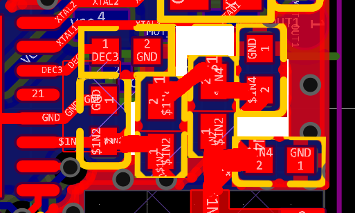

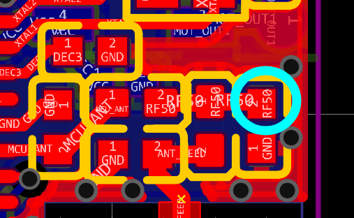

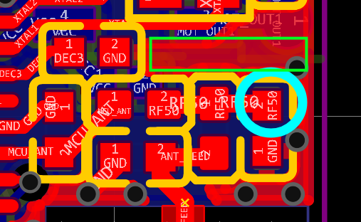

    Meanwhile, I've tried to fit 2nd matching network as you suggested, and found ways to add this without stubs (or with 1 stub, or with 2), at the cost of a bit more bendy antenna trace and a capacitor sticking out into decoupling area.
    Which do you think is preferrable? Should I prioritize removing stubs or it's not a big deal because they are small?
    On a similar note, considering traces between components are about 1mm long, much less than quarter wavelength, how important is impedance-matching them? I can't even decide whether to treat them as microstrip or coplanar waveguide as there is not much ground around them.
    Either option should be OK. I would go for the layout with the one stub, as this allows for GND vias to be added between the RF section and the 32MHz crystal, improving the shielding between them:
