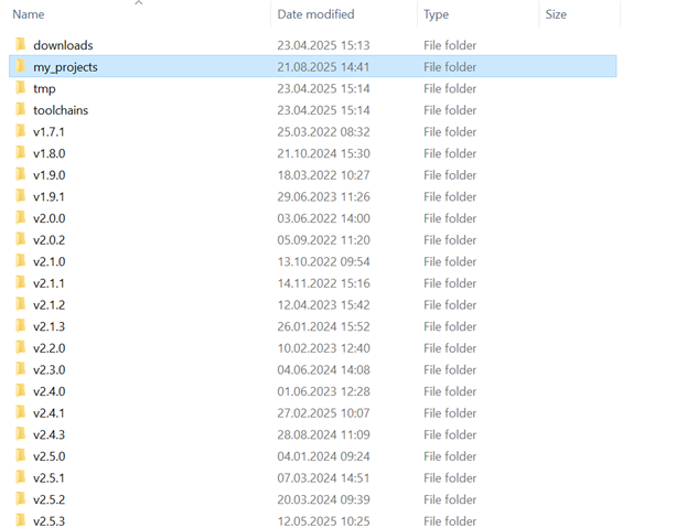

  • I am sorry, but I am not sure. I have it like this:
    Where all the applications that I work on are inside the "my_projects" folder.
    I am not sure, from your west.yml or .west/config where your application is stored, relative to the SDK itself.
    Edvin

  • Oh, I see. i thought you said that it was deleting the SDK folder, but you are saying it actually deleted the folder containing the west.yml. Then I understand why it is frustrating (and unexpected) that deleting the SDK deleted your application. Thank you for clarifying.

    If your SDK is not west-managed, then clearly your situation is different.
    Indeed. My west.yml files are inside their respective NCS version folders: "v2.0.0", "v2.1.0", etc.
    I will report this internally, and see if there is a better way to do this.
    Edvin
