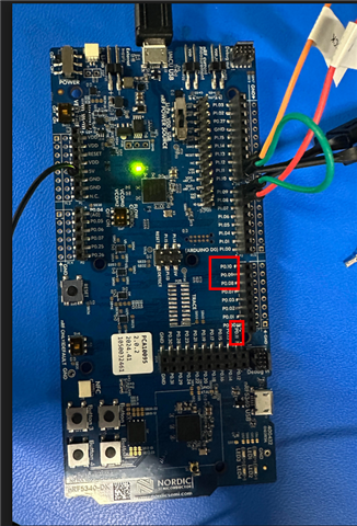

    Heres a link to the screen shot of my physical pinout:

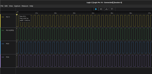

    The physical connections shown in the linked picture do not match your pin assignments. Perhaps you uploaded the wrong picture? In any case, I made a simple test to check if the pins are available on the DK.
    Log trace from my test
    Test project
    3731.gpio_test.zip
    NOTE: Not shown here, but P0.10/RTS was sometimes pulled low by the interface MCU because of automatic HWFC detection failing. As mentioned in the user guide, the UART lines are supposed to be tri-stated  when no terminal is connected. To make this more reliable you may need to cut the solder bridge for the RTS signal (https://docs.nordicsemi.com/bundle/ug_nrf5340_dk/page/UG/dk/solder_bridge.html)
  • Hi Vidar,
    Thanks for running that test and sharing the details. After double-checking, I realized the issue was on my end, I was using the wrong pinout. With the corrected assignments, I was able to reproduce the same behavior you showed using your test code.
    One thing I did notice: on a board where I had cut the solder bridge for the RTS signal, P0.10 measured at a little under half of the expected voltage (~1.3 V) compared to the ~3.0 V seen on the other pins. When I swapped to a new board (with the solder bridges intact), the problem went away. Out of curiosity, do you happen to have any idea what could be causing that behavior?
    Thanks again for your help! It is very much appreciated!

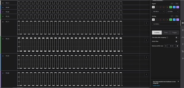

    While running the exact script you shared on my nRF5340DK board, I noticed something unexpected: pin P0.10 only reaches about 1.5 V, whereas the other pins (P0.09, P0.08, and P0.11) reach the expected 3 V. I also cut the solder bridge (SB50) associated with P0.10 based on your suggestion due to the automatic HWFC detection issues, but that didn’t seem to improve the behavior.
    This issue appears to be unique to P0.10. When I moved the same logic to a different pin, it reached 3V as expected. I also don’t believe this is a bus conflict, since the code you shared explicitly disables any other buses P0.10. I’ve observed the same behavior on a second board as well, which makes me suspect there may be a configuration detail I’m missing or something fundamentally different about this pin that I’m not accounting for.
    Do you have any ideas on what might be causing this? I’ve attached a logic analyzer capture for reference. Thank you!
  • Check hardware docs or the DK backside - P0.10 is CTS from the debug interface MCU.
    You have 2 outputs fighting each other.
