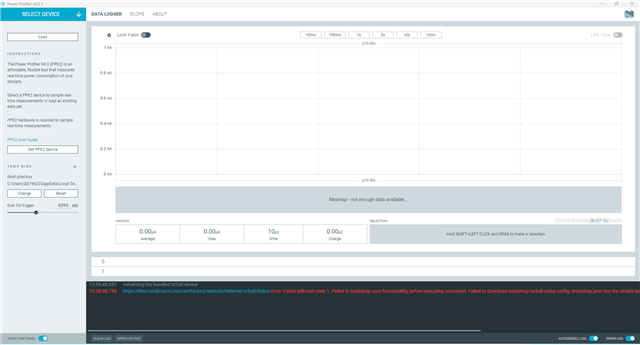

PPK could not be recognized
My new PC could not find PPK in the power profile menu, even I installed different version nRF connect desktop or different Power Profile versions. I always could not find my hardware setting menu.
Error indication:
12:56:58.758
https://files.nordicsemi.com/artifactory/swtools/external/nrfutil/index/Error: Failed with exit code 1. Failed to bootstrap core functionality before executing command. Failed to download bootstrap tarball using config: bootstrap.json See the details below for further information on the error. Caused by: The system cannot find the path specified. (os error 3)
Could not find PPK2 setting menu in my Win11
    Have you tried on a different computer?
    Benjamin
  • My old PC is Win10, PPK2 works well, my new PC installed Win11 version 23H2, PPK2 could not works, always shows "The system cannot find the path specified. (os error 3)"
  • yes, i have downloaded the file from https://files.nordicsemi.com/artifactory/swtools/external/nrfutil/packages/nrfutil/nrfutil-x86_64-pc-windows-msvc-8.0.0.tar.gz directly in the web browser?,  but the problem still exist,

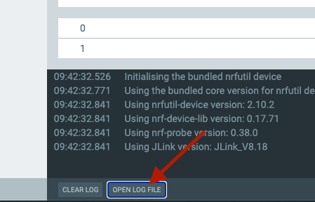

  • 16:04:02.031
    Initialising the bundled nrfutil device
    16:04:21.543
    Successfully installed nrfutil device version: 2.10.2
    16:04:24.239
    Using the bundled core version for nrfutil device: 8.0.0
    16:04:25.045
    Using nrfutil-device version: 2.10.2
    16:04:25.045
    Using nrf-device-lib version: 0.17.71
    16:04:25.045
    Using nrf-probe version: 0.38.0
    16:04:25.045
    Using JLink version: JLink_V8.18
    16:04:26.296
    Getting serial port options from the persistent store for C9FCEFCA6DB1.pc-nrfconnect-ppk
    16:04:26.297
    Device connected with the serial number C9FCEFCA6DB1
    16:05:08.299
    Selecting device with the serial number C9FCEFCA6DB1
    16:05:11.135
    Selected device with the serial number C9FCEFCA6DB1
    16:05:13.489
    Connected to the device with the serial number C9FCEFCA6DB1 and family: Unknown
    16:05:13.773
    PPK started
    16:05:13.773
    PPK opened
    16:05:20.009
    DUT ON
    Today I install PPK2 in my old win10 PC and update it in old PC, then install PPK2 in my new PC, it works well now, happy to see it.
