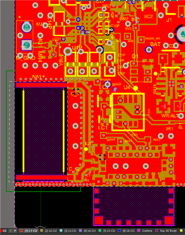

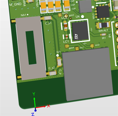

Do you agree that the following AI response is accurate? If so, I understand it to mean that I need 3 capacitors:  one 68pF in series with each NFC trace and one 430pF in parallel with the NFC traces?

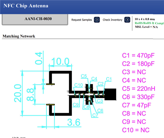

The AANI-CH-0030 NFC chip antenna from Abracon (inductance 0.298 µH, DCR 1.62 Ω, Q-factor 15.7 at 13.56 MHz, size 10 x 4 x 0.8 mm) can be used with the nRF54L15 NFCT (NFC Tag mode) by adding an external matching network to tune the resonant frequency to 13.56 MHz and match the chip's impedance.

  • Two series capacitors (C_s1, C_s2) between the NFCT pins and the antenna ends to adjust impedance matching.
  • One parallel capacitor (C_p) across the antenna ends to tune the resonant frequency.
  • Schematic configuration:
    • NFC1 -- C_s1 -- Antenna end 1
    • NFC2 -- C_s2 -- Antenna end 2
    • C_p between Antenna end 1 and end 2

  • C_s1 = C_s2 = 68 pF (standard 0402 or 0603 ceramic, ±5% tolerance, e.g., Murata GRM1555C1H680JA01D)
  • C_p = 430 pF (0402 or 0603 ceramic, ±5% tolerance, e.g., Murata GRM1555C1H431JA01D)

  • The nRF54L15 NFCT is passive tag mode (NFC-A Listen), so the matching focuses on resonance at 13.56 MHz for reader power harvesting.
  • No inductors needed in the matching network (the provided values are capacitor-only).
  • Test for reading distance (~10–30 mm per Abracon datasheet) and adjust C_s for impedance (target ~50 Ω).
  • For Altium, create a custom footprint for AANI-CH-0030 (10 x 4 mm) and add the network components in the schematic. Import BOM via Reports > Bill of Materials > Import.
  • If C_int for nRF54L15 differs (check Nordic support or devzone.nordicsemi.com), recalculate C_p = 462 pF - C_int - (C_s / 2).
This setup tunes the AANI-CH-0030 to 13.56 MHz for nRF54L15 NFCT. For precise values, prototype and measure with a VNA.
