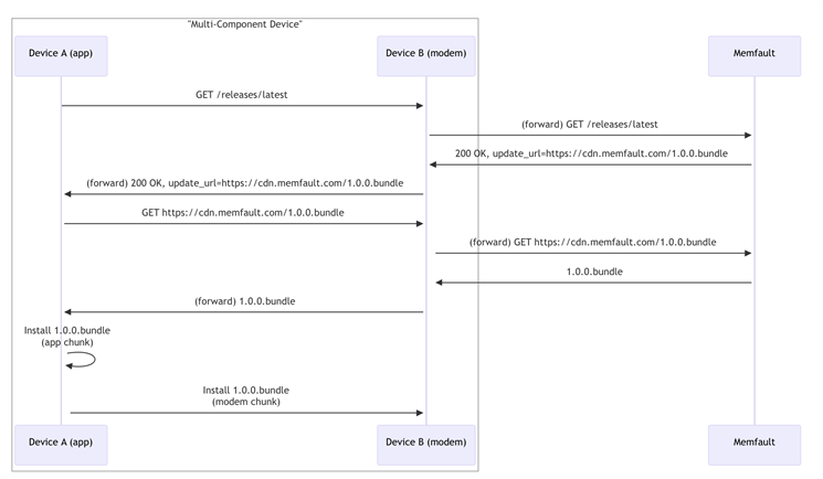

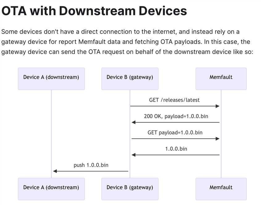

Im currently in the process of integrating Memfault OTA on the nRF9151 DK. My project has multiple boards: nRF9151 DK connects with nRF52840 DK via UART for communication. For OTA, I figured that I can use memfault OTA to update the nRF9151 DK because it supports out of the box. However, I'm not sure how to approach for nRF52840 DK. I know that since 2 boards connect using UART, I can put it into DFU mode and just do a serial recovery. From Memfault doc:
Or the doc recommends to bundle the update into 1 OTA:
Since the nRF9151 DK has external flash, it has enough storage for this approach as well. But memfault guide http://mflt.io/nrf-fota-setup said to just call memfault_fota_start to start the OTA process. That works great for the nRF9151 DK, but what about the nRF52840 board I have connected? The document doesn't mention this very clear on how I could do the "get" and "push" for downstream board, or how I can do the "bundle" approach.
Even if I don't consider the nRF52840 DK, I still need to update both the app and the modem fw on the nRF9151 DK. Which function/API should I override? Or is there already an implementation? The only function I can override is the memfault_fota_download_callback, but this is called after everything is done. I just want to check if the payload is supposed to be for the nRF52840 DK board and save it in a different partition instead?
I'd appreciate the help. Thanks so much.

  • Thanks for the question  ! This is a somewhat complicated feature, so bear with me-
    1. We recommend sending a custom update bundle (as you saw in the docs), however we don't currently have a built-in library for handling this scenario, so you'll have to generate your update bundle yourself, as part of the build process
    2. You'll need to enable `CONFIG_DFU_TARGET_CUSTOM=y`, and implement the custom dfu target handler functions (notably, make sure `dfu_target_custom_identify()` can identify the header in your bundle, i.e. put a magic string at the front of it):

    3. To apply the downstream device update image, you'll want to use SMP over the serial port connection
      1. You'll need to enable serial SMP on the downstream device
      2. You'll want to include calls to `dfu_target_smp_*` functions inside your `dfu_target_custom` handlers, to properly execute the SMP update when processing the custom update: github.com/.../dfu_target_smp.h
