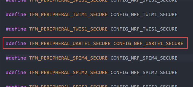

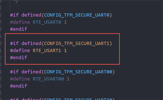

Hello DevZone,
I have a confusing question about TF-M. Need  help from a TF-M expert.
In this document, it says that we must disable uart1 in non-secure application, because TF-M use it as secure peripheral.

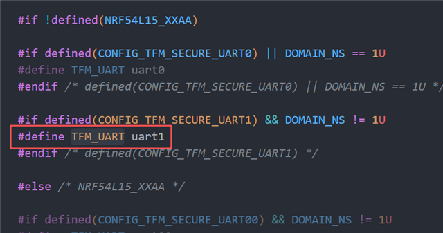

My question is: how does TF-M select the pins used by uart1_secure?
My board selection is `nrf9160dk/nrf9160/ns`, which is a non-secure board.

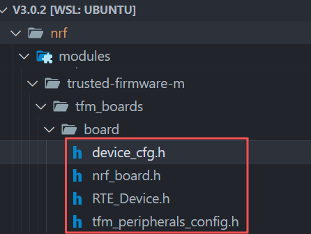

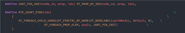

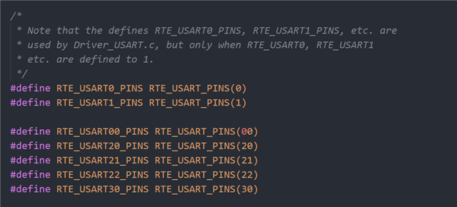

I use AI to read the build progress and all the Ninja things. And it told me that TF-M just read the non-secure `zephyr.dts` and use the pin-ctrl of that.
I think this is not reasonable, because uart1 is disabled in my application. There is no reason for TF-M to use the pin-ctrl from a disabled uart.
More general question: how can I choose a peripheral as secure or non-secure in NCS? Should I configure this in Devicetree or Kconfig?

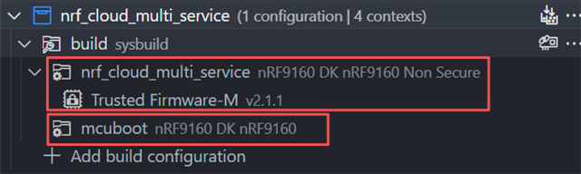

  • I have confirmed that:
    1. TF-M doesn't have a stand alone sysbuild configuration, it is a part of the Application
    2. TF-M will use application's non-secure uart1 pinctrl, even if uart1 is disabled.
    CONFIG_SERIAL=y
    CONFIG_TFM_LOG_LEVEL_SILENCE=n
    &uart1 {
        status = "disabled";
    &pinctrl{
    	uart1_default: uart1_default {
    		group1 {
    			psels = <NRF_PSEL(UART_TX, 0, 16)>,
    				<NRF_PSEL(UART_RTS, 0, 14)>;
    		group2 {
    			psels = <NRF_PSEL(UART_RX, 0, 17)>,
    				<NRF_PSEL(UART_CTS, 0, 15)>;
    			bias-pull-up;
    	uart1_sleep: uart1_sleep {
    		group1 {
    				<NRF_PSEL(UART_RTS, 0, 14)>,
    			low-power-enable;
